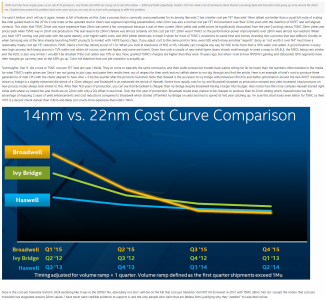

It was only fabless firms claiming 28nm and below continued to increase in cost per transistor?
