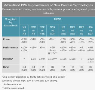

.. and not a trivial one either. 9% density improvement in a tweaked N3 process. Low risk, high yield, what's not to like?
I wonder if the price will be the same or lower than N3E/N3P?
Pretty good business model TSMC has going for it. They keep improving the capabilities of their older equipment in parallel with developing new equipment processes for the generational increase.
I suspect it lets them continue to charge more premium prices on older equipment even when new equipment is introduced. Helps pay off that God awful initial cost of new equipment in Lithography these days.
N3X can also improves power reduction by lowering supply voltage, customers have the flexibility to use these methods to enhance competitiveness of product design. N3X will be in production in 2025.
N3X designs can be lower power in addition to reduced area vs N3P.
At the same speed only.

I’d be surprised if Apple doesn’t use N2 next year, I know the rumors are that they’re supposed to be N3P.
7.5% less power draw compared to 27.5% less.
Or
5% performance increase compared to 12.5% more performance.
and 15% denser.
If both are expected to be HVM in H2 2025. I don’t see why Apple would compromise on a weaker process. They always pay for the best.

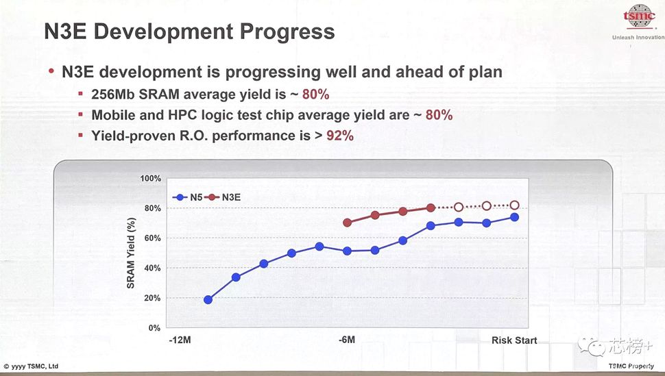

I don't know. If "H2 2025" means the same as "H2 2022" and "H2 2023" meant for N3B & N3E respectively, then yeah. Both entered mass production in mid/late December - probably just to tick a box in N3B's case so TSMC could claim they kept the timeframe they'd committed to since there were no known products using N3B shipping until Sept 2023.
We know that N2 reached target yield for risk (80%) in late May, and formally entered risk production in the first week of July, so one "H2" is not like the others. TSMC typically is in risk production about a year, which would allow them to enter mass production around June 2025. Which is too late for iPhone 17.
Keep in mind though, TSMC's "mass production" is an arbitrary target of 90% yield. That's what they commit to deliver to customers, so that when customers buy wafers they can model how many good dies they'll get based on their die size and ability to tolerate defects (via redundant structures and/or binning parts with fewer working cores, less cache or whatever)
So what happens if you have a customer who because they prepaid a couple years ago is first in line for a new process and they say "we're OK with it if the yield isn't quite 90% when you start delivering wafers" so maybe they enter mass production three months earlier when the yields are only 87 or 88% but still on target to reach 90% by June? If you're TSMC you say "OK we'll informally start mass production of your wafers March, and you accept the risk that the yields may not meet our normal standard of mass production quality" and bingo A19P ships in iPhone 17 Pro/Max in September and M5 follows in October/November made on N2.
I'm not saying that WILL happen, I'm saying that it could happen and knowing what we know today (what I have mentioned above about the risk production dates and TSMC indicating N2 is progressing very well) and assuming we don't later hear some news of bumps in the N2 road if I had to bet today I would bet Apple ships N2 based iPhones next year. And if that happens, I'd say there's an almost 100% chance that Apple will ship A16 based iPhones the year after that.
Executor_
Mar 4, 2010
20
N3B went into mass production in December 2022. You state that mass production = 90% yield. Would TSMC have amended their contract with Apple to known-good-dies if that was truly the case?

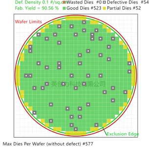

dttprofessor
Jun 16, 2022
163
45

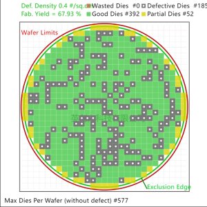

10mm*10mm D0=0.1 & D0=0.4
N3B was a special case, it was widely rumored even before it entered risk production that was it was a very problematic node, and TSMC was not making their usual claims about how it progressing well and showing off graphs comparing its yield at various stages to previous processes like they had with N5.
It obviously entered mass production not only well below the mass production threshold but well below the risk production threshold. We don't know the exact terms of TSMC's contract with Apple when Apple prepurchases a massive number of wafers, but presumably TSMC was on the hook to deliver Apple a mass quantity of 'N3' wafers to allow them to ship iPhone 15 Pro/Max in Sept 2023.
As Apple was the only known customer for N3B until Intel recently started taking N3B wafers (perhaps not coincidentally right when Apple's demand for N3B wafers dropped precipitously) they knew they had to be in mass production in time for that, ready or not. Presumably somewhere along the way Apple demanded some sort of discount for TSMC not meeting their mass production yield standards and KGD is what was agreed upon.
If you look at the graphs TSMC has produced in the past showing the yields you can see their targets - and actually now that I see them again they've started mass production below 90% with N7 and N10 it appears, which may have had something to do with the product schedule of their largest customer...

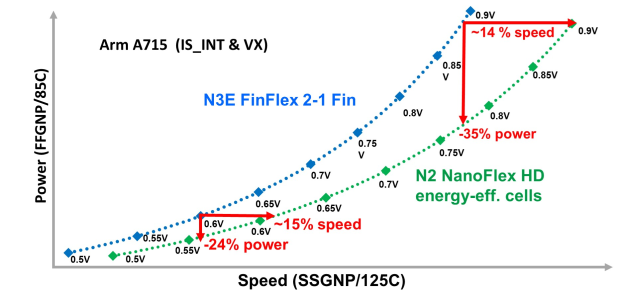

Look how sad those numbers are. New nodes used to give 2x density, almost as a given.
15%? 10%? 7%? This is in the level of within a node improvements now. N3P was 4% over N3E, and N3X is 10% over N3P.
And to get those pathetic gains they need to do a LOT more now, such as BSPDN, nanowires, etc. By the way, Intel gives same pathetic numbers. 30% density over Intel 3 for 18A, and for 14A, it's 20% density over 18A. It looks better than TSMC, but they are behind, so it doesn't look too good.
