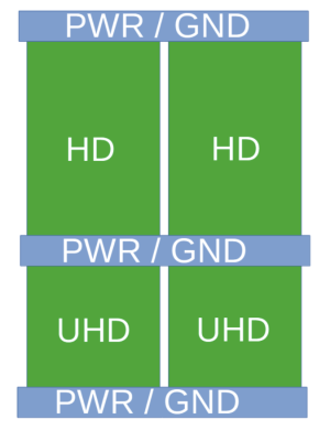

The base HD cells are 2-1? I thought that was the finflex version with the base HD cell being 2-2.
Yes, 2-1 is Finflex, but by base I meant what their comparison point is. The advertised numbers they gave for density, performance, and efficiency improvement. If you compare 2-2 from N5 family to N3, the numbers are different.
That last post reminded me that I never followed up on how Finflex works with mixing HD and HP cells. Basically, Finflex allows you to mix HD and HP cells in the same design, giving a HP row for critical timing paths and HD row for paths that can be slower. I'm not talking about a theoretical design where HD cells are used for E-cores and HP cells for P-cores, but rather the P-cores being designed with a mix of HD and HP cells (or HD and UHD cells for E-cores). This is done through a row based approach where, say you are using 3-2, then 1 row of cells is 3 fins cell height, and the next row of cells is 2 fin cell height.
Then any paths requiring high speed go in the top row and lower speed paths go in the bottom row. Since you have to keep the whole row the same height, this probably leads to paths that don't require high speed, still being in the high speed row, just because trying to put only high speed paths in the high speed row isn't practical from a layout perspective, but this will obviously be design dependent. I made a very quick and ugly figure to show what I am trying to describe. The green are the different cells and the blue are the pwr/gnd rails (it will alternate pwr, then gnd, then pwr or vice-versa).

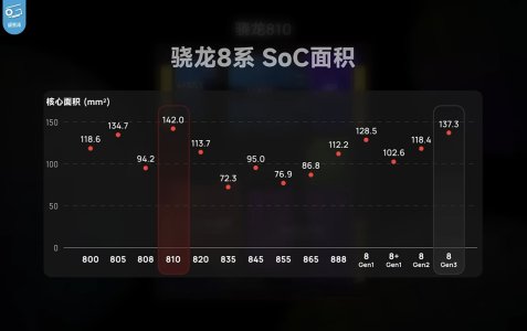

Note the die size reduction from 8 Gen 1 to 8+ Gen 1.
They are both the same SoCs. 8 Gen 1 is on Samsung 4LPX, and 8+ Gen 1 is on TSMC N4.
This means N4 is a whopping 25% denser than 4LPX.

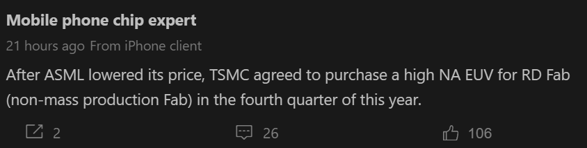

I don’t think this is real or I am mis-understanding something. In a quarterly conference call in April of 2022 ASML said;
Roger Dassen
“…So, I will try and give you a non-answer to your question on the High-NA orders, Adi. So, we did disclose that we have 5 orders for High-NA 5000, for the 5000 system. That's an R&D system. We've also indicated we have multiple orders for the 5200, and we've also said that we have these orders from three logic customers and two memory customers, and that's really what we can share…”
This would lead me to believe that TSMC had an order in on a development NA-EUV machine since 2022 as they are one of three logic customers. I seen a rumor is that ASML already starting sending TSMC their 5000 development machine.
This is inference and rumor on my part as there is nothing explicitly said by ASML but as a betting man I don’t think TSMC is waiting for ASML to lower the price.

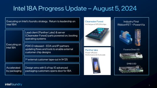

First good news out of Intel in a while.
In the Deutsche bank conference today we got our first real numbers on how Intel’s new processes are yielding.
Excerpt below:
We described that as our five nodes in the four-year journey and we see the finish line in the site. And since we released the fifth of those, right, the PDK for Intel 18A, we've seen a market uptick in activities in the industry. We now have about a dozen customers that are actively engaged with us around that PDK. We have eight product tape-ins that we expect to finish by the middle of next year. And of course, Panther Lake and Clearwater Forest, our first client and server product. And I'm happy to update the audience that we're now for this as a production process, we're now below 0.4 D0 as defect density.
I’m guessing he gave hard numbers on defect density in response to Stacy Rasgon and the report in Digitimes. That’s not a bad defect density for this stage in development, that’s actually pretty good considering how complex 18A is.
Ok, I guess but they'll need to execute their plans nearly perfectly to have any chance.
