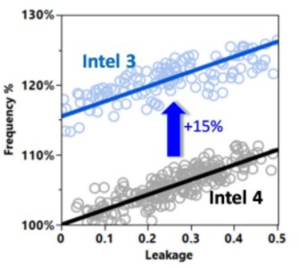

Intel will do a presentation about Intel 3 at VLSI Symposium 24:
Advanced CMOS Technology
“An Intel 3 Advanced FinFET Platform Technology for High Performance Computing and
SOC Product Applications” – Intel Corporation (Highlight Session – Paper T1.1) This paper presents Intel 3 FinFET technology fully optimized, providing 10% logic scaling,
performance and reliability improvement compared to Intel 4. Through transistor
enhancements, interconnect optimization, and design co-optimizations, up to 18% iso-power
performance gain is achieved over Intel 4. Intel 3 additionally enables a 210-nm high-density
standard cell, 1.2-V-native I/O transistors, deep N-well isolation, and long-channel analog
devices to provide full-featured technology design capabilities.

Honestly, it's fine, but Intel calling this Intel 3 is hella misleading. Also, SRAM shrink hopium is also dying. Maybe the perf/watt is good, idk.
This is a bit surprising tho. Wonder if Intel 20/18A's density jump over Intel 4/Intel 3 is really that bad.
Falls in line with the paper you shared some time ago that 18A MMP is basically the same as Intel 4.
