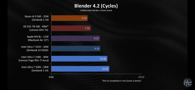

No offence, but it doesn't look like a blowout at all to me. In fact, it looks like a 12 core Zen 5 is beating a 14 core M3. Note: it is doing this from a process node behind (N4P vs N3E I believe).
M3 is on N3B. Using Passmark to judge performance is not good. Just look at this chart, it doesn’t even make sense.
Also there is no way M3 max 14 core is losing to HX 370 in real world CPU tests.
Especially when the base M3 in a fanless laptop comes close to a HX 365 while using less power in Blender.
Now add 6 more P cores and a fan and you get the M3 Max.
In any case in the laptop space everyone has their own use cases and Zen5 isn’t competing with M3 but M4 as well.
