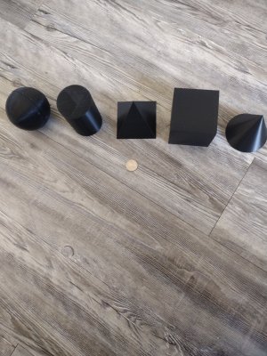

Just 3D Printed A Chess Set
Just want to point out that there's a serious risk of choking if the objects are too small or there's a chance they'll break.
Well I never used the food safe filament but the filament I do have is VERY durable.
I don't think it's even possible to break it with your hands, especially not a toddler.
Also, the shapes I made are pretty large.
I mean you have to be REALLY sure. Kids will destruction test everything and they have no survival instincts.
Your examples did not look like they'd easily break or be swallowed as a choking hazard (but a bit hard to tell the exact size from your photo). I'm pretty sure the dangers are more from the grooves in the end-result of any FDM 3D printer. Perfect breeding grounds for bacteria--especially once they are put in a mouth and are simultaneously bacteria covered and wet. Plus, the colorants in the filament are never food safe. It doesn't matter how food safe the plastic is, as soon as they are dyed they are no longer food-safe.
