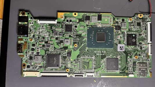

The board is as per attached
I am really starting to lose faith in this, and I like you are not one to give up easily.
Why would this company change the panel type for the same (identical) Model machine

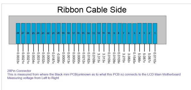

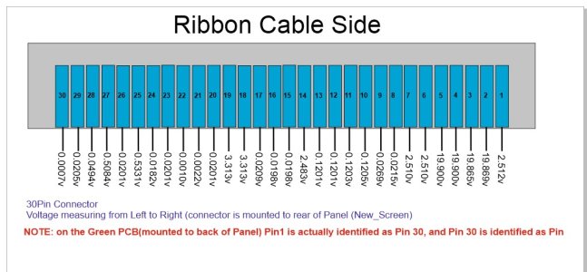

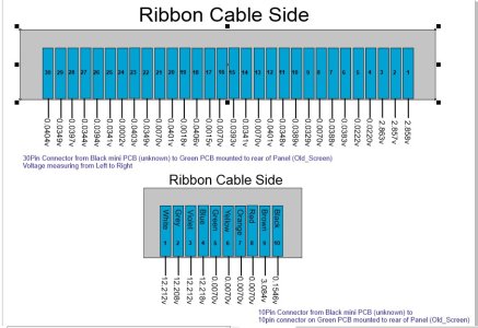

I was doing a lot of digging the other day and someone mentioned elsewhere about taking "Voltage readings of the pins on the connectors" and then comparing them........
Well I have taken the voltage readings with nothing but the DC power supply connected and the board "powered up".
This is my last resort to trying to get this working and if not then at least I have given it one last try...
I hope you do not mind me sending these readings to you, and hope they make more sense to you. I tried to compare them but I keep losing track.
