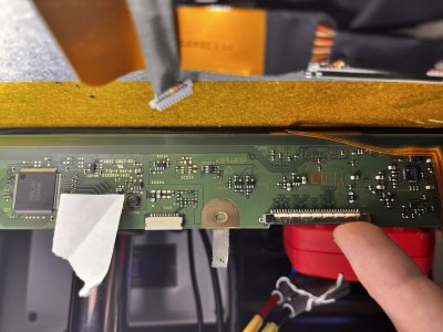

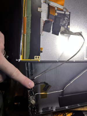

If you look at this image, it displays both connectors, but if you look above the 30pin connector you can see the fpc that is connected physically to this pcb
This is where I am very very confused...
Ive tried researching all those part numbers, but nothing comes up
I can't tell form the pic either. Larger connectors usually mean more bandwidth. Does the panel connect to that and then another cable front the side or bottom to the mobo edp connector? The other end of the cables might give us a clue.

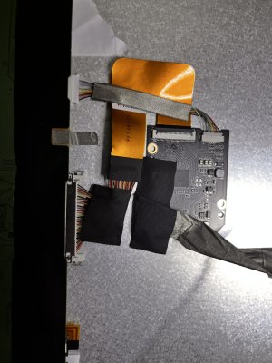

1st image - full overhead view of the back of the panel and lid:
Displaying the 2 x fpc's (in image are both coming in from the left side ) from the LCD/TFT to this long SHARP manufacture motherboard which I believe is a TCON.
Then outputting from the SHARP motherboard are 2 x connectors (1 x 10pin and 1 x 30pin)
Both of these connectors plug into a second (BLACK) pcb (separately)..
1 connector which is twisted wires that are soldered to an FPC cable, which then plugs in the 30pin connector of Black pcb;
2nd connector is 10 x twisted wires that then connects to another 10pin connector which is then connected to the other connector on the Black pcb.
Underneath the black tape (which I forgot to remove) is another 30pin connector....this connects to the flex cable, which splits to the fpc connector that plugs into the main motherboard LCD connector, and also up to the webcam.

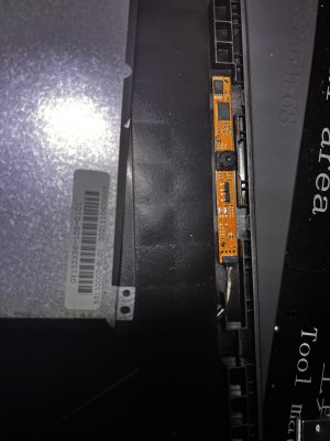

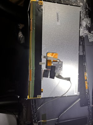

The second, third and forth images are just close up views for you
The 5th image is the back of the Black pcb

5th image
Well, the final photo gives me a clue but, doesn't make much sense why it's needed nor the PCB on the back of the panel.
LVDS is a legacy way panels used to get hooked up. The thought passed my mind when you mentioned the 10-pin but, didn't think it actually could be a possibility. The PCB across the bottom the panel does a passthrough 30<>30 and it would appear the 10-pin might be for the backlighting function?
They sure did a number on obfuscating things here. If I pull my panel off there's just the single EDP cable and then the other functions are separate to the cam / wifi / etc.
This cost cutting measure they're doing is a real pain w/o documentation. All sorts of hidden mess behind the screen.

My only thought would be remove the drive board and just plug the EDP cable directly into a replacement panel. The only iffy thing is whether the GPU will support it or if it's coded to use LVDS only.
The whole setup behind the panel. Just getting rid of it and plugging in the EDP to the panel directly from the MOBO.
But the driver board is the PCB across the back of the panel on the bottom where the 2 plugs plugin.

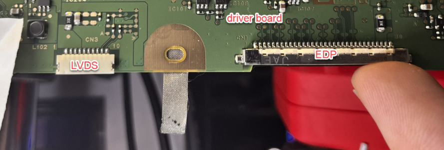

The only issue with that is that the Drive board does not plug into the LCD and is directly connected (soldered/heat applied) or however it is affixed to the drive board.
The 2 orangey brown fpc's (shown in 1st image and zoomed in 3rd image)

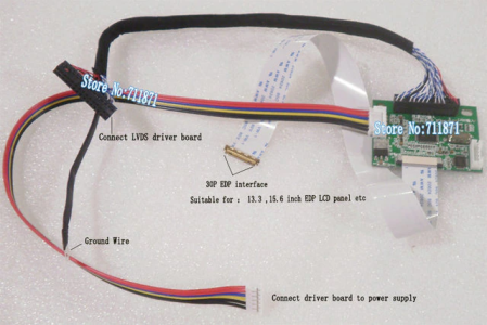

Are you talking about the ribbon cables between the LVDS adapter and the driver board and the driver board to the panel?
The idea is to disconnect the EDP cable from the square adapter board and connect it directly to a new panel. Then toss all of it in a box or bag and not look back unless the new panel doesn't work. It's just an added PITA that likely doesn't need to be there in the first place.
So, knowing this driver board / adapter run s about $10-$15 there's potential this is the issue unless the screen is damaged.

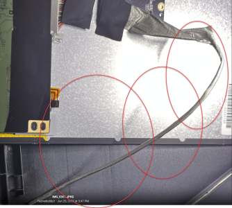

Another snap shows the PC capable of 120hz though even though in this size the max is 60hz w/ a 30p cable. If you pull the tape off the cable I circled that connects to the LVDS adapter how many pins do you have there? Might be 40p since HWI shows 120hz capability from the PC side.

No not the ribbon cable between LVDS and the driver board..but the driver board to the panel.
The 2 ribbon cables that come out of the driver board and go straight into the panel. This connection is not a connector and has been installed using micro soldering or heat
I think you're getting stuck on dwelling on the LVDS and rats nest of a solution they used.
My point is to toss it all and get an EDP panel instead of dealing with all of the cables. Just hook the new panel up to the EDP cable directly from the MOBO.
The issue at this point is taking the tape off the EDP cable from the MOBO to get a pin count as it could be 30 or 40.

Lastly, per your request.. under the tape is a connector with 28 pins (not 30pin or 40pin) and on top of that, the ribbon cable that plugs in to the Black pcb also only has 28 pins 🤷‍♂️ 🤷‍♂️
28 pins is a bit odd. Knowing that these cables aren't a 1:1 pinout though means there's probably an adapter you could use.
Since it's an Intel CPU and using a UHD igpu it should natively support EDP. It's going to take a little detective work to find the pieces but I think it's doable. If not an adapter there might be a cable that goes from the mobo to the panel that would convert or even the mobo side might be 30 pin natively this just need a 30 pin cable replacement.

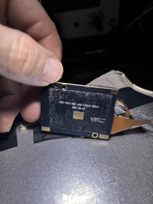

I have decided to go in deeper with investigation to see what on earth this manufacturer was playing at, and you will not believe your eyes....
See below image
YEP!!!!! a 34 pin connector but only "21" wires are used between MOBO and input to Black pcb
(INET-P313-EDP-TO-LDVS-CS511-REV12) 🤦‍♂️ 🤦‍♂️
From my experience (which is very minimal) - I believe they are treating this like it is a SCART lead but without the monstrous size plug... which would look silly sticking out of the side of a laptop haha
and so that Black pcb is converting a SCART input into an edp or lvds output... is it not??
