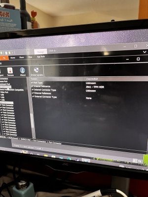

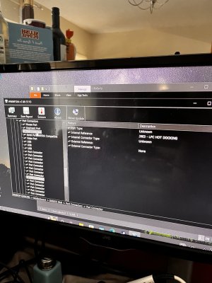

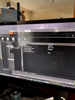

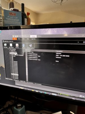

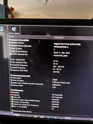

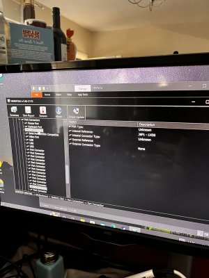

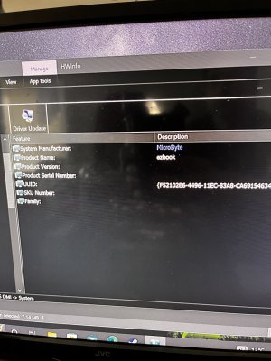

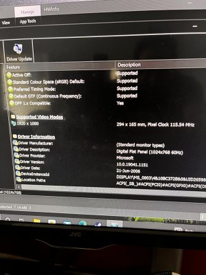

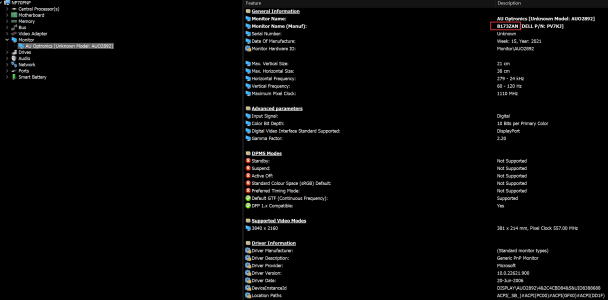

So I have followed your advice, I have ran HWInfo and got so much information... what a program, its amazing!
I have attached a couple/few screen shots for your info...
I can confirm it is a PBTB133F006-A panel, and the laptop specs only state it being a Microbyte Ezbook, but don't inform of the exact model however, using the other information provided I can confirm that I have narrowed it down to the Ezbook X3 model (as I originally thought) but definitely was good to get clarification.

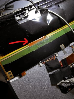

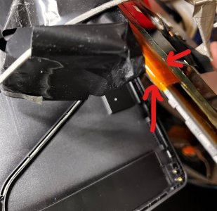

Finally, whilst I am sourcing could you also confirm that this panel replacement will be close to true likeness... because the issue I am seeing is that the larger SHARP pcb panel which is (or was) affixed to the back of the panel does not connect to the panel via any connector, and the actual 2 x fpc cables are soldered (well I am sure they are soldered) to the SHARP pcb.
Congrats!
So, the things I would look at are the video connector and whether the panel is screwed to the lid or not I see the hinge screws but, most panels are usually just double sided tape / foam these days.
Next is figure out the size diagonally with a tape just to get an idea of the physical size. The model number hints it's at least 13" but might be 13.3". Count the wires on the edp connector as it could be 30-40. From there you should be able to find something that fits on panelook that can be ordered.

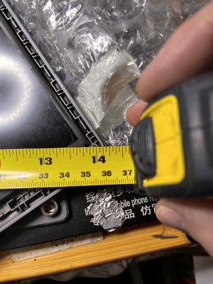

Its a bit of an odd one..I cant work out if its 13.3" or 14" < I work in CM or MM normally (another picture attached).
Its screwed to the lid.
I counted the wires and its definitely 30 wires.

Also, the measurement I took was placing the start of the tape measure to the outside edge corner.... should this of been measured where the outside of black tape (think its called shading tape) ends.. making it the visible screen size perhaps 🤷‍♂️

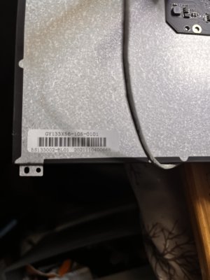

The physical label on the back of the panel is as per previous image, yet when I input that into Panelook..the screen dimensions do not seem to tie up.
According to panelook the panel should be 13.3", yet my tape measures closer to 14"....Am I doing something wrong.. I will check with a straight solid Metal rule and see if its the tape measure that is inaccurate (although I can't see how)

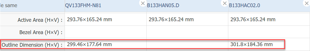

I'm going with 13.3' on this one
So, I would be looking at those and fhd / 30p / edp w/ mounting holes.
The one photo says it's 16*29cm so, convert that and you should get the size I inches.
I would start with these.
The concern though between them is the outer size and whether it will fit inside the lid.
Now, for me I would be looking at better color options as well but, for this size that means looking at the 4K options or at least having a 40p EDP cable. There are ways to convert from a 30 >> 40 cable but, the pinout isn't always a match on the active wiring.

One is the screen viewable size and the other is the physical size of the edge to edge measurement that fits inside the lid.
So, the 13.3" 16*29CM is the active / viewable size.
The outline size will come into play though as it might offset the mounting tabs that it screws into. There's not usually too much variance between MFGs but, sometimes there's enough to make you need to make adjustments to make them fit. Ideally you just want one that just drops into place w/o pressure. Being that your specific model doesn't pop up with specs / measurements it's a bit of a tedious task to take measurements manually vs just being able to pull them up for comparison.

Reason I ask is because those models do not share the 30 pin connector and the 10 pin connector. I cannot see a way for me to connect the 10 pin connector required to power the mini pcb
10 pin connector
Does this plug into the panel or to an adjacent connector that goes back to the mobo?
Take it off completely and take a pic and see if we can identify it and what it does. The first thing that comes to mind is it's just a webcam unless it ties into the panel wiring.
