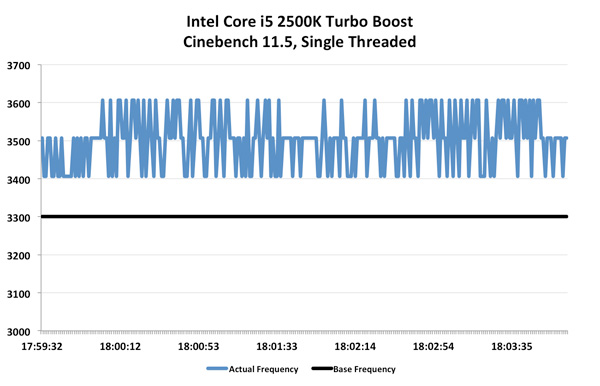

I don't agree, 4GHz is the max frequency, average frequency is much less even in single threaded benchmarks, so it's hard to say which CPU has higher average frequency in single threaded or dual threaded benchmarks.
pelov
Dec 6, 2011
3,510
That gets more complicated when you take into account the way the turbo works depends on whether the module is tasked with a single thread or two threads and how many modules are filled/not filled.
There's max frequency turbo, which is the advertised turbo, and the regular turbo which is the non-advertised turbo.
And then you have to throw the scheduler in there as well... It gets really messy =P
The thing that we should remember, though, is that AMD's Turbo in BD is actually very very good (better than Intel) and its one drawback is that it just doesn't clock high enough in either of the two modes.
Intel's chip is the one throttling here, and apparently needlessly at that. Although Anand wasn't completely sold on the Asynch clocking feature I think it's a great idea if the scheduler is made aware of how the chip is designed. It could potentially save a significant amount of power for a chip this size -- and if you look at the idle power consumption figures it's quite clear that it has too. All's not horrible with Bulldozer, there are definitely some great ideas AMD implemented. It just sucks that the performance wasn't there.
http://www.anandtech.com/show/4955/the-bulldozer-review-amd-fx8150-tested/4
