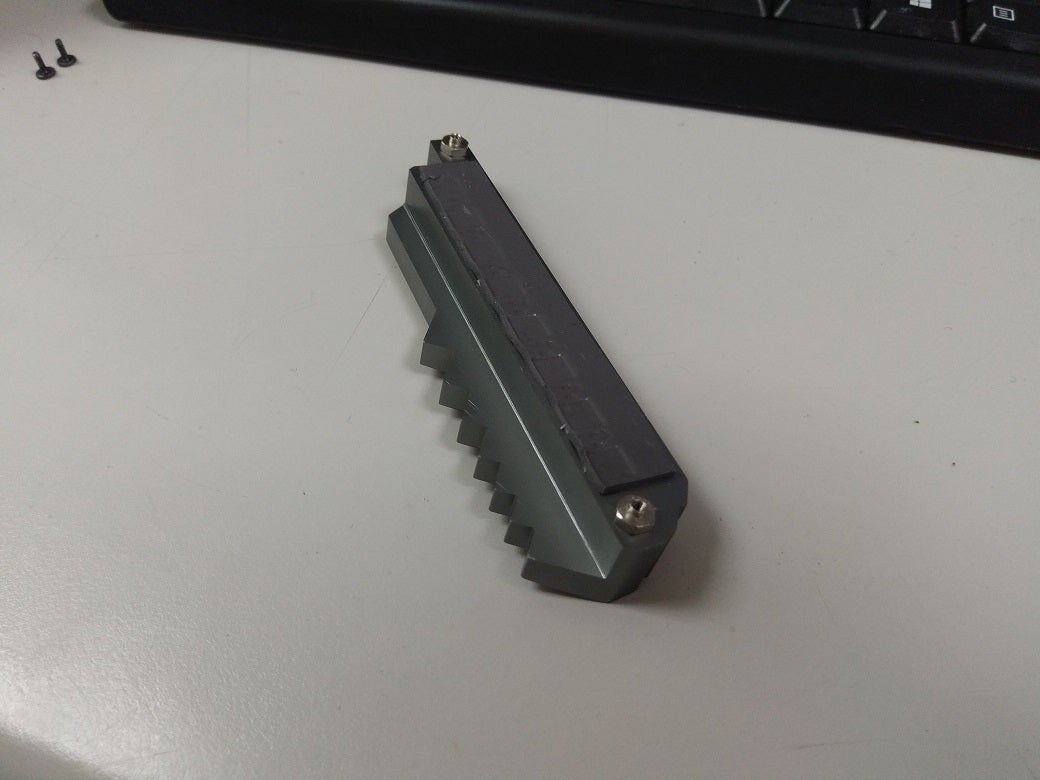

I mean, when your heatsink is like this(Asus X299-A), with a white finish on the other side,
you know you're heading for trouble.

What happened to the era of copper heatsinks, I wonder?:rolleyes:
I don't understand why they even stick on these big metal lumps. Anyone who knows anything about heat transfer will know they are idiotic! They might act as a sink for very brief transient power peaks, but any sustained operation will quickly saturate the heat capacity of the lump.
A few copper fins on the VRMs to increase surface area, then have a small fan running air across them. If the VRMs are running at >100 degC, then that small bit of airflow will keep them cool - regardless of whether the internal temperature of the box climbs up above 50/60.
