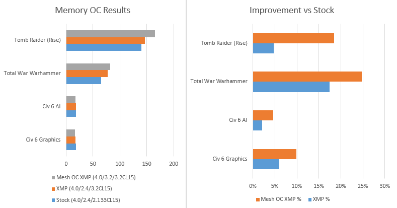

Just one set of limited results, but the mesh/L3/RAM memory latency impact is huge for Skylake X.
