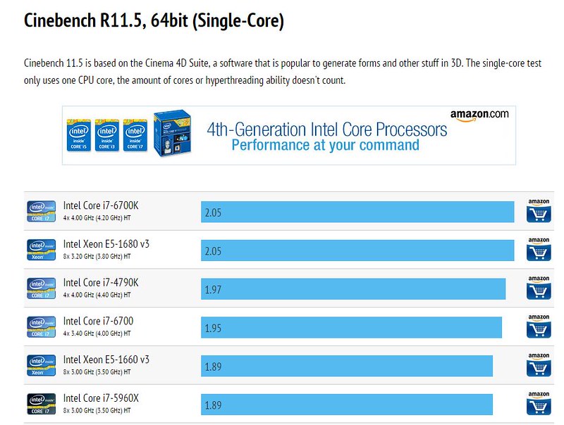

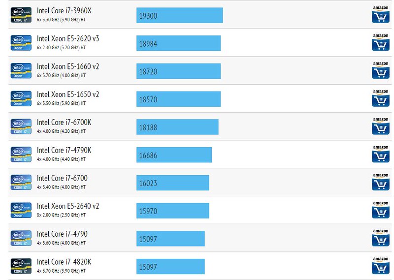

some leaked benchmarks
Geekbench single core
Geekbench multithread
Cinebench R11.5 sinle
Cinebench R11.5 - multithread
Cinebench R15-single core
Cinebench R15 multithread
http://www.cpu-monkey.com/en/
I'm a bit surprised by these. I was expecting or rather hoping for a consistently dominant improvement over previous generation(s) and when a 39xx at a lower clock speed (even on a single core test) does better...
Perhaps it's too early to tell.
Don't forget to account for clock speed differences in the single core tests. When I do, I get a consistent 9% IPC improvement for the 6700K. Actually, it's so consistent I'd call it suspiciously consistent. :hmm:
