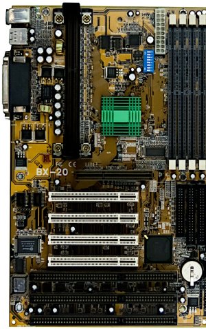

Yeah, at that Abut mobo which allowed to use 2x Celeron 300A@450 before Intel disabled multiproc with Celerons.

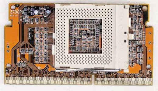

Yeah, I had an Abit 440 "BX" MB. Lasted 3 generations of CPUs with a slot adapter.
I think it was pushing nearly 1GHz by the EOL.
Mine was a PC Partner 440BX that could clock a Celeron 700 Mhz to 1050 MHz using SoftFSB utility whenever I wanted. It was dang stable too but did require an extra fan blowing on it to prevent the system from locking up due to excess heat.

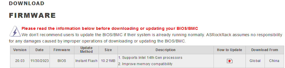

Looks like someone in that thread is right about the mobo companies messing with consumer mobo settings. Look here: https://www.asrockrack.com/general/productdetail.asp?Model=W680D4U-2L2T/G5#Download
So after 14th gen support, there is no new BIOS, even though their Z790 mobos have beta BIOS available to fix the 14th gen stability issue. This means their workstation mobos were released with "correct" settings from the beginning and there's nothing to fix there.
WOW. Maybe the mobo makers deserve Intel throwing them under the bus...
