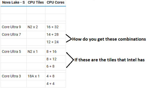

I have created table with the leaks about NovaLake-S desktop lineup in the frontpage, Core Ultra 9 sure looks like badass in term of thread numbers. With bLLC, Intel might bring back Extreme Edition to justify high price tags, what do you think?
Thanks for making the table. I am suspicious of two of your Nova Lake Core Ultra 7 core counts though. How do you get those specific combinations?
Do you think for the top Core Ultra 7 that Intel will put its best two tested tiles together (8P + 16E) and (8P + 12E) and just disable two P cores simply for price differentiation? That seems odd. I would assume that instead the top Core Ultra 7 would be this combination of tiles (8P + 16E) and (6P + 8E)* = (14P + 24E).
Similar argument for your lower Core Ultra 7. Wouldn't it make more sense for Intel to combine two (6P + 8E) tiles* to get (12P + 16E)? Your listing of (12P + 24E) means that Intel uses a perfectly good 8P chip and disables 2P cores simply for price differentiation. Wouldn't it make more sense to use more of the 6P chips up?
I have no evidence of what Intel will do, I'm just trying to justify what would make the most financial sense for tile combinations. Or do you think Intel is making a 14P core chip simply for the Core Ultra 7 lineup, but can't make a 16P core chip.
* For clarity for @511, the (6P + 8E) tile is a binned (8P + 16E) tile.
Do you think for the top Core Ultra 7 that Intel will put its best two tested tiles together (8P + 16E) and (8P + 12E) and just disable two P cores simply for price differentiation? That seems odd. I would assume that instead the top Core Ultra 7 would be this combination of tiles (8P + 16E) and (6P + 8E) = (14P + 24E).
Similar argument for your lower Core Ultra 7. Wouldn't it make more sense for Intel to combine two (6P + 8E) tiles to get (12P + 16E)? Your listing of (12P + 24E) means that Intel uses a perfectly good 8P chip and disables 2P cores simply for price differentiation. Wouldn't it make more sense to use more of the 6P chips up?
there is no 6+8 Tile btw it's just a binned version and since 2P cores has to be disabled like a 4E Core Cluster it is possible to make
6+12 and 8+16 = 14+28
6+8 and 6+16 = 12+24
it's totally dependent on binning
Of course it is dependent on binning. I was assuming people knew the 6P+8E was a binned 8P+16E chip.
The two I highlighted in red would be chips that are not on the table.
