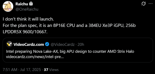

Yeah but anyways what's the guesstimate for the CU Counts for NVL Halo? i am expecting 5-6 Render Slice(6 XE Cores per Render Slice) with Xe3P arch.

this is 24 Xe3P cores lol Internally the count is based on legacy EU For some dumb reason so it's like 24Xe3P Cores
They said Pantherlake iGPU is 40% faster right? That's with a 50% higher compute unit count, so aside from niche scenarios(where Battlemage is weak at) there isn't much per EU/MHz perf gains.
So 24 Xe3P is essentially B580 in a mobile form factor. Yes it has 20% more units but mobile is slower plus bandwidth is only about 2/3rd.
Looks like from eyeballing and rough search it should be fairly competitive performance-wise with AMD.
