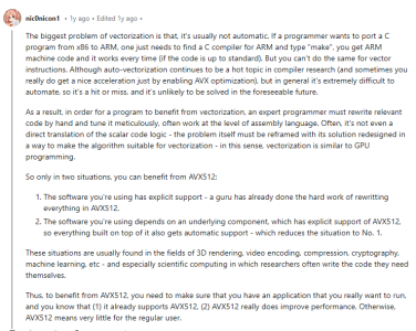

Relevant sure, but how much vector performance contributes to the performance of the core in your average consumer workloads is debatable.
Ray tracing is also a factor when considering the performance of two different graphics cards, but many people would say that rasterization is much more important than ray-tracing thus it's unfair to compare a 6950xt to a 3060 based solely on ray-tracing.
I mean if vector performance is so important why did Intel fuse off avx-512 silicon in multiple generations of golden-cove and it's derivatives. Workloads such as Lib264 encoding demonstrated here would have benefited a ton from AVX-512. If vector performance was so important for the general use-cases of consumers then intel left double digit performance improvements on the table.
There also is the question of just how easy it is to solve this specific issue. I'm not CPU architect but it seems to me that having relatively weak vector performance is much less of a problem to fix than having weak int/fp performance to begin with. With skymont already being such a good base, why would adding features and improvements to beat a p-core so unfeasible?? It's already 1/3 of the area of golden cove while offering similar IPC in many scenarios while being able to clock 5Ghz without being designed for high clocks. I'd say there's much room left for improvement.

Relevant sure, but how much vector performance contributes to the performance of the core in your average consumer workloads is debatable. Ray tracing is also a factor when considering the performance of two different graphics cards, but many people would say that rasterization is much more important than ray-tracing thus it's unfair to compare a 6950xt to a 3060 based solely on ray-tracing.
These are general purpose cores meant to be sold in pretty much every segment, if you're going to completely replace the P-core, it needs to be able to compete in pretty much every category with at least decent competitiveness.
Because the E-cores didn't support it and they couldn't figure out how to make a mixed instruction set big-little CPU work in software. AVX-512 is all kinds of messy as well for Intel but that's a whole different discussion.
Yep, and it just led to further confusion and difficulties around adopting AVX-512. They got criticized for it quite a bit.
I'm not saying it's impossible, or even ill advised, for Intel to move to their E-core architecture entirely, just that the comments of adding a few tweaks and having a world class, small, efficient core top the charts is not realistic. It may compete extremely well in many thread scenarios and in many integer heavy workloads, but will still get smoked in several work loads. To get to a more fully competitive design will significantly increase power and area. Adding full width support for wider vector operations not only increases power and area on its own, but you have to be able to feed the beast as well which means expanding other parts of the core. Even in lightly threaded integer workloads, you either need to increase IPC or frequency enough to compete with designs clocking 20+% higher, neither of which is easy and will add additional area and power. The point is, by the time you do all that, the E-core is not going to look so much like an E-core anymore. If done right, it will probably be much better than what the P-core team can put out, but it's not going to be a few tweaks here and there and you get an E-core competing in the competitive P-core landscape. That's just not realistic.

These are general purpose cores meant to be sold in pretty much every segment, if you're going to completely replace the P-core, it needs to be able to do compete in pretty much every category with at least decent competitiveness.
No one is debating that, but nonetheless skymont cores are excellent for what they are designed to do and a good showing of what might come in the future.
And also maybe because it's not entirely useful for consumers??? I get your argument for all these AVX support for datacenter but I really don't see how it's such a big deal for 99% of consumers buying a cpu for their PC.
Criticized for wasting die space and money on AVX-512 sure. But I don't think anyone was claiming that somehow giving AVX-512 support for CPUs was going to revolutionize their product. Zen5 is the first full fat AVX-512 implementation and yet it barely improves upon zen4 in any meaningful way for consumers.
For consumers, a few tweaks would indeed lead to a world class, small, efficient core while also being much cheaper to produce. I literally linked a benchmark video where they turned off all the P-cores except one and left all 16 e-cores on which led to faster gaming performance than the default configuration. Ofc some leeway should be given here because the default configuration has scheduling issues, but if you compare the results to the 8P test and the new FIXED cyberpunk benchmarks then you see it is pretty close if not on par.

Even compared to Zen2, skymont has a 128-bit SIMD unit width versus Zen2's 256-bit width, which also puts skymont at a disadvantage in vector performance as well.
It is not so simple. Skymont has 4x128b symetrical SIMD units, Zen2 has asymetrical units so for inner loops of things like matrix multiply they are equally matched.
Past stupid decision when Intel thought it owned the marked, so they thought market segmentation will be good for them as they would be able to milk avx512 as a bonus feature. So it got completly ignored in consumer market until Rocket/Tiger lake and then Intel cut the support after one gen as they needed E-cores to save face in Cinebench.
Now if you think Intel thinks that AVX512 is not useful in consumer market then why they are rolling out AVX10?;) it only purpose is to bring AVX512 features to E cores as AVX10 doesnt require 512b execution units. With AVX10/AVX512 the compiler will spill less often, due to bigger architectural register pool, even for scalar floating point operations. Handling corner cases is easier thanks to masking etc.
