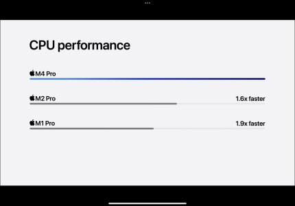

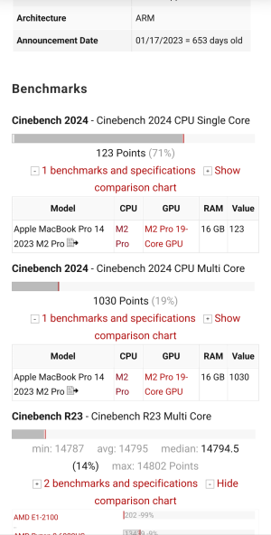

M4 Pro is 1600 r24 ( from slides)(45-50W based on M3)
M2 Pro is 1000
U9 185(1000 at 65W) iirc
Strix is 1250(65W)

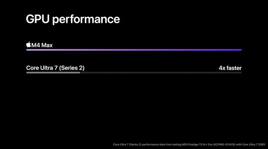

GPU performance in what? Doesn't looks like It's in a game.
Don't ask me i don't make apple slides they didn't mention anywhere what did they test.I am pretty sure that LNL and M4 GPU are within 10% of each other.
They also claim M4 Pro 20 Core gpu is 2X faster than M4 GPU(10 Core Version) additionally it has 2X bandwidth it would be half
It’s up to 2.2x faster than the CPU in M1 Max and up to 2.5x faster than the latest AI PC chip. M4 Max
The GPU features up to 20 cores for graphics performance that is 2x that of M4, and up to 2.4x faster than the latest AI PC chip M4 Pro
Apparently 2.4X of 258V and 2X for M4 apparently U9 is 5% faster so M4 iGPU is roughly 15% faster CPU being 150% faster
