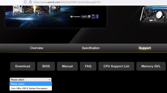

Who would want to buy this dud if its a one-and-done socket?
I've got serious doubts about that because why would ASROCK go to the trouble of putting a dropdown option in memory QVL unless they know that Core Ultra 300 series is gonna be supported on Z890 too?

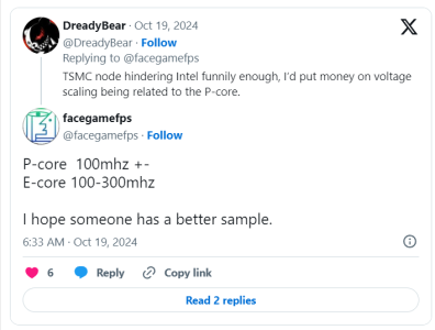

So a little more power efficient than Raptor Lake (maybe 20%?), but still less power efficient than Zen 5 while having a node advantage. I guess the only interesting thing left is what is the overclocking headroom on the e-cores to see if it can actually be the undisputed multi-core champion.
Jays2cents claims almost 1GHz headroom on the 285K's e-cores in his recent video which would be pretty crazy if you could get the e-cores up to something like 5.3-5.4GHz range - assuming he didn't misspeak.
Reactions: lightmanek

Jay is wrong, it’s up to 300MHz. Not almost 1GHz.
He made it sound as if Intel told him that. Then again, the entire video feels like an Intel commercial where they get to throw the mobo makers under the bus while Jay is driving.
I expect the E cores to have better OC potential than the P cores because Intel will bin for P frequency. The E core bin would have to be a wider net, and will probably have higher variance (hence the higher OC potential).
