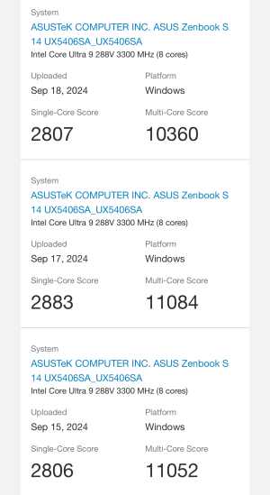

Figured I’d update the thread with a couple recent GB6 scores for the 288V. Looks like it’ll be about the same as the HX 370 (Zenbook S 16) in ST.
Pretty much confirms 2800-2880s ST, and right around 11000 MT.

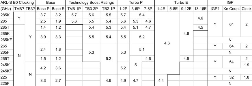

This schematic will do, but yup 4.6GHz all-core for Skymont in the unlocked SKUs:

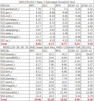

And since Raptor Cove is 5% better than Golden Cove and Redwood Cove 8-9% behind Raptor and thus a few percent behind Goklden Cove, appears Skymont per my Golden Cove test of 12600K and SKymont screenshot accurate, appears Skymont has within 1-3% of Redwood Cove IPC aftercall.
Once again not quite as good as the +2% better than Raptor Cove that it promises, but still darn impressive and appears Chips and Cheese is right. Though it varies by workload a lot I imagine and maybe best case is 2% better than Raptor Cove with all around performance being Redwood Cove IPC.
I wonder what the clock speeds are running all 12 cores
The Ryzen 5900X also 12 cores scores 9471. It has SMT though. SO wonder how much uplift SMT gives it giving it a higher score than the 8983 12 Skymont scores in the screenshot leaked.
What do you think?
16 skymont almost equals to a 5950x.
