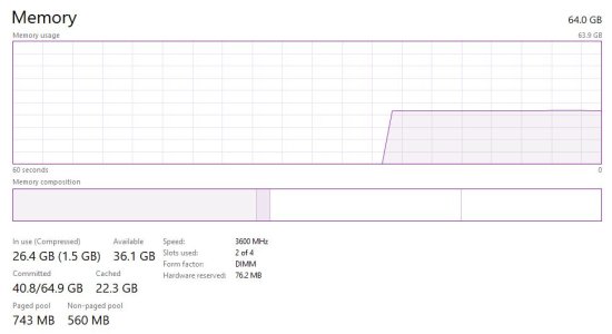

I must be really old, I remember upgrading to 4gb on my pentium 4 and feeling utterly destroyed by windows XP 32bit not letting me use the full amount, even if it was only by a few hundred MBs.
I simply cannot relate with anyone that wants less performance on new hardware. Have any of these people talking about not needing 64gb ever even used a system with that much ram?
All I have open on this PC are two web browsers, discord, and steam. And I am already very near 32GB of RAM.
I've already heard all the arguments, stop using bloated browsers, don't use discord, its only due to windows memory allocation, I don't care. If the software I use wants RAM, why wouldn't I give it RAM? And also if we consider windows itself, don't forget caching is a thing. And with that counted I'm already at 40gb aka way past 32gb.
Now, please consider a high end intel SOC with a decent iGPU. You'd probably want to give at least 8gb of RAM dedicated to graphics right? On a 32gb laptop that cuts you down to 24gb, and that's already less ram than my PC is using to run chrome and firefox. 64gb on laptops, especially ones with brand new extremely powerful chips, shouldn't be scoffed at.
poke01
Mar 8, 2022
4,761
6,095
Ok then what about people who want 128gb they get stuffed?
Why does X Elite top at 64GB or Lunar at 32GB or M3 at 24GB. I guess those people get the M3 Max or Strix Halo.
Seems like your real need is to close browser tabs and learn to use the history to instantly load what you closed weeks/months/years ago. Chrome's grouped history is really helpful for that when you take the time to learn to use it.
Why purchase an expensive new system and then just clog it up, probably soon to a crawl, with unused web browser tabs?
