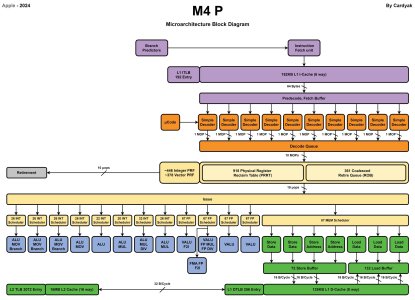

For comparison, the P-core of Apple M4 allegedly has 8 ALU, 4 FP ports, 1 port for FMA, 3 load/2 store AGU, 3 load, and 2 store ports.

FWIW as far as I know Apple P cores can issue 4 128-bit operations per cycle including FMA.
Yes, M-series chips have four FP 128b ports, but I'm not sure if the FMA is supported on all of them or just one.

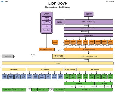

That's the same number as what we have in Skymont (with the FMA support on all of them).
As for Lion Cove, it also has four FP ports, but they are wider (256b).
Proof here that there are 4 FMA: https://scalable.uni-jena.de/opt/sme/micro.html
M4 runs at 111 GFLOPS FP32: that is close the theoretical 4.4 GHz * 2 ops per FMA * 4 FP32 * 4 FMA = 141.
But only two FMA so that's the same FMA bandwidth as M1+.
