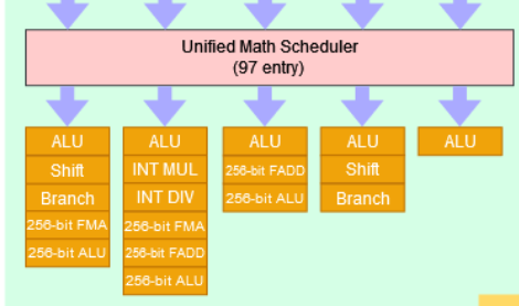

You took my words about the scheduler too literally. Never mind.
Look carefully again. You can clearly see at the beginning, where the FPU part is, 4 execution ports and then 6 execution ports, which gives a total of 10. Right? The remaining 8 are from SD and AGU.
Except that's not how Intel sets up their math scheduler...
Here is what Golden Cove's Math Scheduler looks like.....
Notice how the FP ALUs are on the same ports as the Integer ALUs..... That's what I expect of Lion Cove.....
I know how Intel up to RedwoodCove uses a schedule for ALU and FP.
In the LunarLake diagram, the schedule in the LionCove core appears to be separate, and this may be a big change from what is currently used. FP Units and ALU Units have separate ports. Alternatively, the FP part also has ALU.
Either way, the ALU ports and FP ports give a total of 10 ports, as you can see in the diagram. Unless you think it's fake.
Like I said, I think you are reading too much into it.....
At this point we don't know enough about what Lion Cove (or Skymont for that matter) actually looks like to assume if the image actually is showing anything notable.... sure there are folks like Raichu on Twitter that claim certain things but there is no "hard" evidence like GCC patches, LLVM patches, perf patches, or MSR documentation out yet other then the ISA manual that Intel puts out which isn't that helpful here (other then to imply that Skymont doesn't have AVX10 but that's a different discussion)........
But if I was to speculate based on the assumption that there is in fact 10 math ports split between 6 integer ports and 4 vector ports, then I would assume that the unified math scheduler is no more and that they have split the schedulers up into a 6 port scheduler for integer operations and a 4 port scheduler for the vector operations while keeping the individual load and store schedulers........
Which is starting to look a lot like that fake Zen 5 slide MLID claimed was real ironically enough....
Except here it would be a single vector scheduler instead of 2 vector schedulers in the slide and a split load and store scheduler instead of a unified AGU scheduler in the slide........
