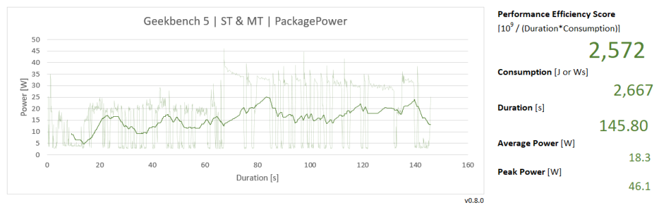

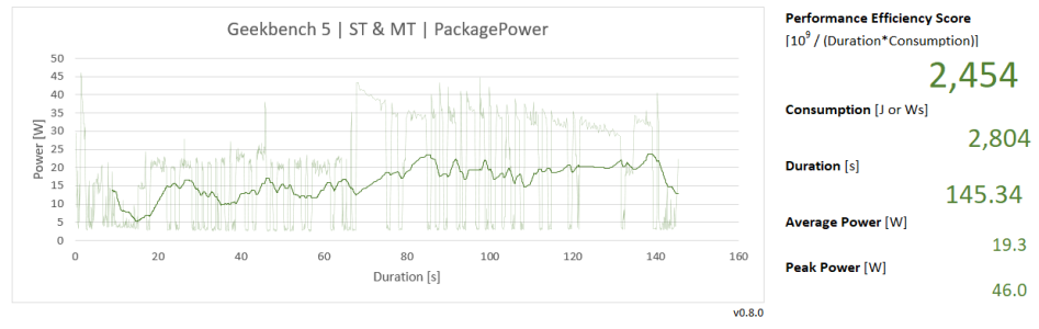

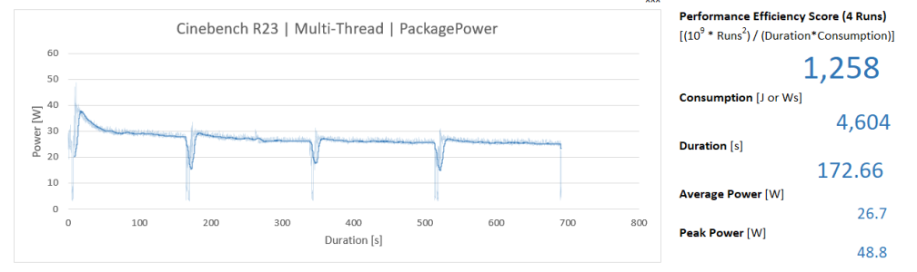

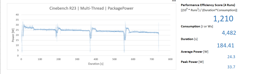

Here is the difference DTT makes in practice:
i7-11370H PL2= 51 W, PL1= 30 W
DTT OFF:
DTT ON:
Sure, performance is a bit lower, but you get similar efficiency and energy consumption vs. DTT off when blasting an all-core load like CB R23 - DTT functions primarily to give better user experience in terms of heat and noise.
DTT ON:
DTT OFF:
DTT in case of a light variable workload - which is Geekbench 5 - actually sacrifices a bit of efficiency for a higher score (as evidenced by the run times).
So efficiency measurement in reviews is completely dependent on context - no one single number can express it when there are so many variables at play in addition to power limits.
