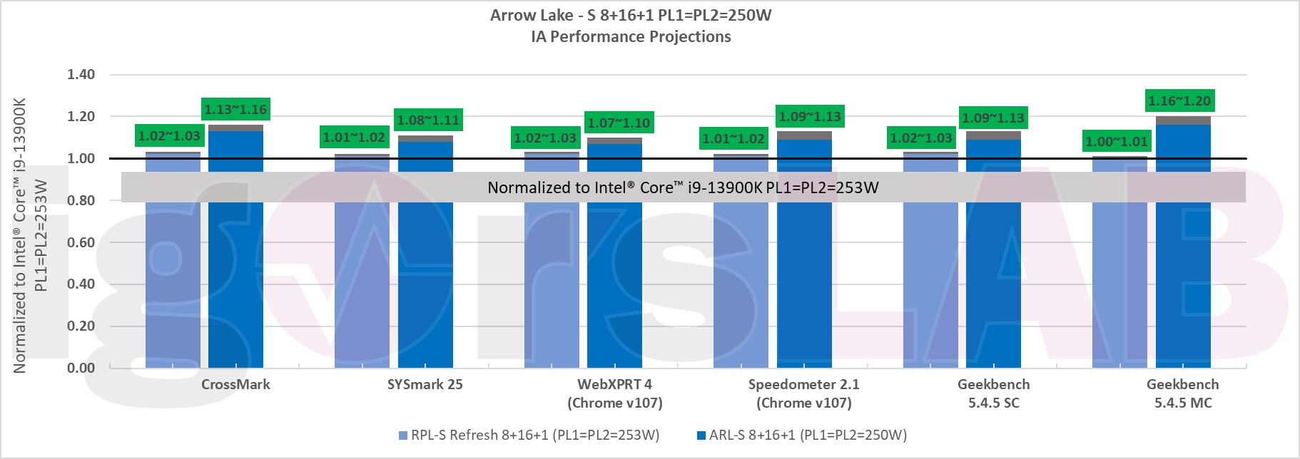

If it's the same leak we've all seen, it's isopower (actually isoPL, since the PL value listed for the 8+16 Arrow Lake is PL2 = 251W).
Just to be clear, the leak is implying that ARL is performing 5% better than RPL at the same power?
There are two leaks. The first one is here:
That leak claims that for 8+16+1 chips, Arrow Lake-S is 2.4%* to 17.4%* faster than Raptor Lake-S Refresh at PL1=PL2=~250 W power. Presumably this is the 14900K they are comparing. Note: the Arrow Lake chip was using 3 W less power (250 W vs 253 W), but they are roughly iso-power. That leak also says 4.5%* to 19.0%* faster than the Raptor Lake 13900K. Then the graphics (3rd slide in that link) is supposed to blow both Raptor Lake and Raptor Lake Refresh out of the water.
* Note: I'm using the midpoint of the estimations for this whole post, since they are a range.
The second leak is from our very own uzzi38 poster with 5% faster single-thread and 15% faster multi-thread:
Maybe he has context as to which Raptor that is talking about, but if so, I don't remember it.
Yes, if it's the old Intel slide. Though the Intel slide showed numbers slightly different than 5%/15%.
Hmm. The first two slides are quite interesting. I am not familiar with those workloads but they could have something to do with the difference between RPL and ARL at iso-power. Here's why. Let's assume that the ARL sample tops out at 5.4 or 5.5GHz and we know the 14900K tops out at 6GHz MT and about 5.7GHz multicore. Under a lighter workload it is possible that both the RPL and ARL will hit their max clocks, meaning RPL will have a significant frequency advantage and thus narrow the performance gap between the architectures.
With a heavy workload it is not difficult for RPL to hit power levels much higher than 253 Watts. So it could be possible for RPL under a heavy load at 253W to "only" achieve a frequency of 5.3GHz all core. ARL on the other hand may be much more efficient and be able to maintain its top frequency even on the demanding workloads, thus only benefitting from better IPC over RPL but also higher realized clock speeds.
This could be why we're seeing the spread from 5% (could be light loads) to 17% (heavy loads), in addition to the normal architectural differences we normally attribute to IPC differences between processor generations.
Anyone familiar with how those tested applications saturate the cores?
Honestly this is probably me looking for trends that aren't there.

I'm not extremely familiar with how saturated those chips would be in those benchmarks. But what you are saying does make theoretical sense. If a chip is running at turbo for extended periods of time, then a more power-efficient chip could be able to run turbo for longer. Otherwise if they have the same number of cores, why would there be better multi-threaded performance gains than single-threaded?
I'm taking my 14900K performance. I have my power limit set to 200W and P/E frequency capped at 5.5/4.3. For most of my applications like Photoshop, Presonus Studio One, Topaz Video/Photo ai, and others the processor will run at 5.5/4.3 well below 200W. But frameserving in Vegas Pro, or transcoding in Handbrake, or testing in CB it will hit that 200W limit and hold at about 5.1/4.1 or so depending on the application.
In the leaks I'm wondering if RPL is hitting the power limit before max clocks, even before getting into the turbo territory. I have found 1-2 core turbo to be all but useless in my 14900K, which is why I cap frequency at 5.5GHz. I don't need 5.8 or 6GHz for a few seconds now and then and a huge amount of voltage for practically no benefit in performance. This of course is a subjective decision based on personal preference and usage but going over 5.5 for my chip/usage was an exercise in futility. At the end of the day I just capped the voltage at 1.3 with LLC 4. I never hit 1.3V, full load is generally about 1.15V and temps are high '70's with great stability. I know, OT!

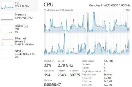

What is the expected Single Thread performance of Lunar Lake?
Meteor Lake does around 2400 points in Geekbench 6 ST.
If Lunar Lake wants to beat Snapdragon X Elite/Apple M3, it will have to exceed 3000 points.

I am not sure this is final clock speed. Based on leaks, LNL should have 1.8 GHz base clock with turbo up to 2.8GHz...
At 8 W power or 30 W or something else? Unfortunately the key piece of data necessary to evaluate those speeds isn't there in that leak.
