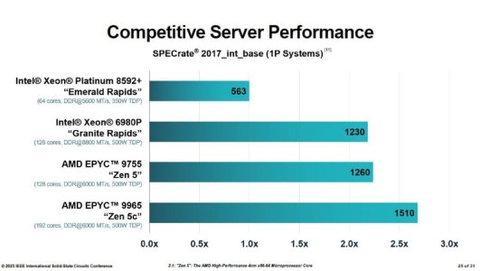

here's why zen6 (tsmc n2) will eat intel A18:
Turin (Zen 5c) is ~20% faster than Intel 3 xeon (AFAIK the only intel 3 product?)
Underlined the models with same core count (128)
mark my words: basically intel A18 will be catching up with zen 5 on all segments
mobile
desktop
server
A18 maybe ~10% faster than zen5 in some cases but wont compete with zen6
For this i have quite the thoughts after looking at the servers released and stuff it will be a long thread.
First This Data is based on Mean of all the results which means if we have some extremes anything can skew the result and also i doubt some results for both AMD/Intel like this one.
a bug in NAMD will it be not fixed?
why would AMD Publish SPEC 2K17 result in their presentation ?
Than there is the process of deciding Server AMD vs Intel
  • 9575F is good where you need fewer but faster cores( good for accelerators and things that are CPU Bound).
  • 9965 is good for Virtualization where you want maximum thread density.
  • 6980P is good for Memory Bandwidth where you need the highest Memory bandwidth.
  • for AI everyone is picking up Xeons cause of AMX for inferencing small models and as a node to drive GPUs in a Cluster. There is no way they will beat GPUs as of now.
  • Than there are workload like OpenSSl/Databases and each of these have their different requirements depending on which you use.
Now the Platform Features like CXL/PCI-E and the biggest thing these Xeon 6 has accelerator for different stuff like Networking/Databases etc no one has benched these and Intel has plugins for everything fully open source.
Now let me come to the core parts in next gen servers, Zen 6 is N2 and DMR is 18AP using Panther Cove. Zen 6(N2) is going to be a big upgrade over Zen5(N4P) i don't have doubts but the thing is Panther cove is an even bigger upgrade over Granite Rapids(Golden Cove with enhancements) it is basically Redwood -> Lion -> Cougar Cove -> Panther Cove . That's like 2 tock and 1 tick with a process enhancement.
Now to the Node i firmly believe 18A is at minimum N3P level of performance (This source is TSMC so make sure you have a better counter point 🤣 ) and at max slightly weaker than N2 in perf/watt but based on Intel's improvement in terms of what the call a '+' i have every reason to believe 18AP is slightly better than N2.
Reactions: Io Magnesso and DKR

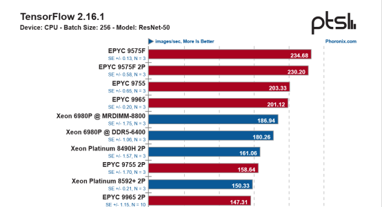

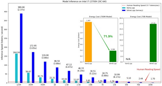

I think people said that about AVX-512 as well when it came it was worse than AMX cause it would throttle the core hard but look at it now.
That is very general and broad statement. Could you list more specifics like who is everyone, and what kind of AI workloads?
I was referring for situations where you don't need GPUs like inferencing small models also I need to edit the point I think as you said it's too broad.
Also this new project
Win2012R2
Dec 5, 2024
1,291
1,354
AFAIK AMX throttles freq down much like original AVX512 did. Maybe it does not matter if you run exclusively AMX code all the time, but what if it's mixed? Should be same bad situation with with original AVX512.
AMX should be better for lower inference latency compared to GPU, but most people will look for reasonable latency + big throughput, which can only be achieved in GPU.
Can't see AMD using it, which in practice means AMX is dead end.
Oh, I thought you know some specific usage data. Thing is small models usually stick to using custom data format which is not accelerated by AMX nor AVX512 (AMX has support for int8 and bf16, AVX512 for bf16) but most models used are quantized to more weird data formats (something that could be thought of as int 4,5, int 6 and so on) and these require custom kernels, were data are being packed specifically to fit in AVX512 registers (which should be true also for AMX) and seeing AMX is less popular than AVX512 I doubt that popular inferencing frameworks (ollama, lm studio etc, all are really derivatives of llama.cpp) will get support unless Intel will provide it on its own due to the custom packaging part and lack of available hardware on the market. I mean you could use the model packed into bf16 but then you need 4x the memory bandwidth to maintain the same speed for token generation vs the popular int4 like quants assuming you have enough memory to fit the model.
511
Jul 12, 2024
5,340
4,754
That is true but AMX is fully supported in llamma CPP and in Pytorch. Intel has provided support since launch of SPR that was nice of them unlike AMD who haven't bothered to provide RCom support for RDNA4.
LOL AMD has copied almost everything what Intel does while the opposite is not true in terms of ISA only exception being X86_64 Extension.
very valid points. interesting how they have similar specint perf
on phoronix review of many use cases https://www.phoronix.com/review/amd-epyc-9965-9755-benchmarks/6 in majority Turin is faster, most cases 10-25% and some even 60%+, while granite rapids is only faster up to 10% in just few use cases, thats how geometric mean is reached
still it's really hard to believe intel managed to jump from intel 7 straight to 3 and A18 so quickly lol. how did they make it??
to answer my question I think it's AI/LLM greatly accelerating R&D. like between decision making and existing assets, they could make it work so both TSMC and Intel got 3 and 2nm class nodes working quickly, also assuming they're both dependent on ASML machinery as well so they go in tandem
maybe it's ASML R&D first and foremost dictating how quickly better nodes come up?
Reactions: 511
