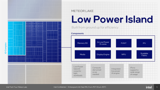

How is only using LP-E cores a "convenenient corner case"? That's the entire point of those cores and the design of MTL.
The idea of the architecture is to turn off certain tiles when they are not being used. Several of the reviews have shown that there are issues with scheduling and turning off the CPU tile when they aren't needed. The big disparities in test results are more likely the result of immature FW and drivers rather than fabrication of data as you suggested.
The numbers from Hardware Canucks don't line up with what you want to see so "they are more or less made up"? This doesn't sound like a very objective take to me.

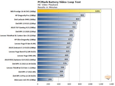

The first 165H review?
Battery life test here looks good:
"Yes, it can be that good. Running the PCMark 10 Battery Video Loop test, we scored the longest laptop battery life for any machine we have ever tested. In case you're bad at math, that is 20 hours and 1 minute. The test was still running as we were preparing to post this review. That is enough battery to watch the entire Lord of the Rings film trilogy on battery power...twice. And you want the kicker? The battery was only 91% charged when we started the test due to Windows' battery protection mechanisms."
However it has a 99.9wh battery and only an IPS LCD.
Saylick
Sep 10, 2012
4,005
9,403
Nice!
They had a little more to say about the battery life:
We didn't test gaming battery life on this machine because it is not a gaming system, but you can bet that it will be considerably lower thanks to the SoC having to keep the GPU tile powered up. You see, part of the reason that the battery life for video playback is so long is that the Core Ultra CPU is able to power down both the graphics tile and the compute tile (with the CPU cores) while simply playing back a video like this. The LP E-cores and the video block both reside on the SoC tile, so most of the CPU is completely shut down during a video playback if nothing else is going on.
Hitman928
Apr 15, 2012
6,693
12,356
Yeah, if you normalize for battery size, it’s not nearly as impressive and loses the top spot to at least the next two in line. Still a very solid showing but not anything that special compared to current competition.

I've heard time and time again the CPU tile can turn off and the 2 LP-E cores on the SOC can do things and save buttloads of power. I'm not buying it. The GPU looks much improved but how can they turn off that tile and still have a usable laptop?
You are misunderstanding this. Look at the graph again. They got about 20 hours of video playback using a 99.9wh battery charged to 91%. (~91wh).
During this playback, the CPU and GPU tiles would be largely turned off. How would it still be a usable laptop? Because the LP-E cores handle the light background processing needs and the display and video decode is handled by the SOC tile, NOT the GPU tile. The Meteor Lake SOC tile contains the display and media engine blocks. The GPU is actually not needed at all to decode video or even drive the display. Everything is handled by the SOC tile alone for the most part.
During this video play if a heavier background process comes up, the CPU tile may be switched back on from time to time but most of the time a light task like video playback wouldn't need anything beyond what is in the SOC tile (the LP-E cores and the display/media engines).
The numbers from Hardware Canucks don't line up with what you want to see so they are "they are more or less made up"? This doesn't sound like a very objective take to me.
You hit the mark.
Calling LP E cores as "convenenient corner case" is the most foolish explanation I've come across. MTL's design philosophy is focused squarely on those LP E cores like you mentioned.
Yeah, they did say they started with 91% battery charge FWIW. For some reason MSI also decided to set this laptop up with dual SSDs in Raid 0, seems like an odd choice for this class of laptop. Seems potentially suboptimal for a low power device.

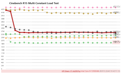

Here is an example of 13900HX 8P+16E.
Power Limit 2: 130W; Power Limit 1: 55W
From 4311pts down to 2649pts. -58% TDP results in -38.5% performance.
8P+8E i7-13700HX manages comparable performance at 70W, so saving 15W by using 2 extra E-clusters isn't worth It. Link
I think It would be similar with ARL 8P+8E vs 8P+16E vs 8P+32E. The last one would be the most efficient, but to be also significantly more performant It would need a very high power limit, which is achievable only in the largest laptops.

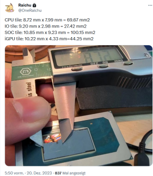

mikk
May 15, 2012
4,293
2,382
From Raichu tile size measurement:
CPU tile: 8.72 mm x 7.99 mm = 69.67 mm2
IO tile: 9.20 mm x 2.98 mm = 27.42 mm2
SOC tile: 10.85 mm x 9.23 mm = 100.15 mm2
iGPU tile: 10.22 mm x 4.33 mm=44.25 mm2
Close to what Andreas Schilling said, CPU and Soc tile a little bigger from Raichu.
They say that the Windows battery protection won’t let them charge to more than 91% so it’s unclear to me whether the other laptops are also at 91% or 100%. However, even if you assume the MTL laptop was at 91% to start and the others were at 100%, it still loses to the next two in line once you normalize for battery life and adjust for the lower starting charge, it’s just in a closer third place.
