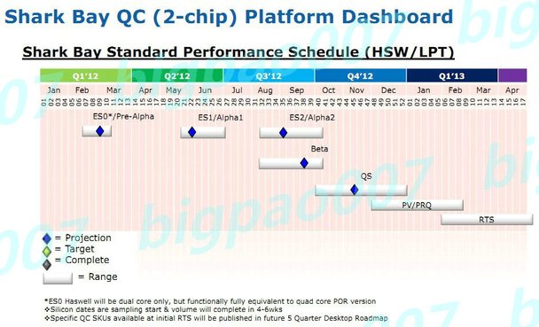

Shintai, the estimated die size for QC Haswell is 20mm^2 larger than QC IB. The difference in size is mostly due to much larger GPU.
There are no QC ES0 samples, and ES1 didnt come before late may this year. That pic is from what, sept 2011?
Even if we say the ES0 was a QC with 2 cores disabled. It wasn't here until feb 2012. Before that only DC existed.

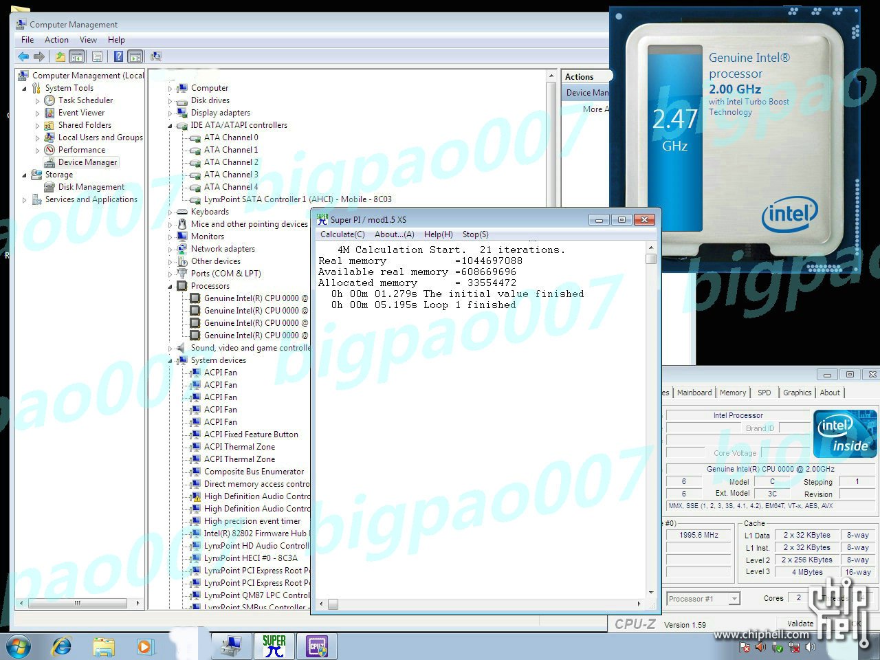

Leaked Haswell screenshot is also a dualcore:

Then how big will the quad core be in the version with the fastest(GT3?) GPU? Is it viable for intel to make a desktop performance part which will be practically almost 2x bigger(2x more cores than ES0+more die area for the GT3) than IB QC we have today? Even in this ES0 version the die area is 15% larger than QC IB.
I still think,judging by the wording intel has used in the slide, that ES0 is a QC die with 2nd fastest GPU and 2 cores disabled.

Even then, it didnt exist in sept 2011 ;)
If we judge by SB. Dualcores was 149mm2, quadcores 216mm2.
Why would it be 2x of IB QC today? You make zero sense in your estimates.
