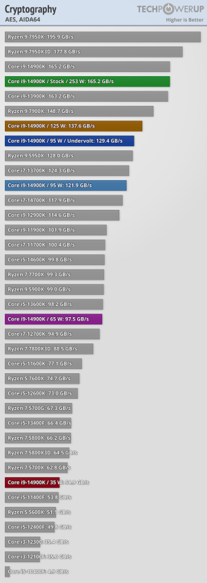

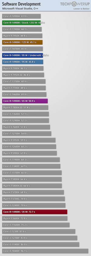

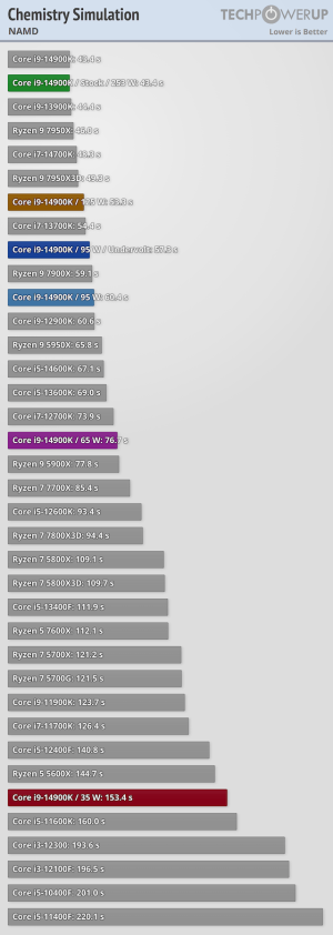

TPU tested i9-14900K at different power limits down to 35W. Check It out.
Performance suffers a lot, but efficiency is great.

7,799
Basically the same story as with the 12 and 13000 series. You can get ~90% of the performance for nearly half the power in most cases.
Those numbers are made up and do not make sense at all, no way that 11% better perfs require 100% more power when starting from 125W.
At 125W you get 83% of the stock perf of a 13900K@253W, at 142W there s 87% remaining perf, so still quite below TPU s fairy tales tests that put RPL at same efficiency than a 7950X...
They're not made up.. they're testing different things. The TPU test isn't strictly a multithreaded test since it includes things like JetStream and Microsoft Apps.
There is no problem with that test, you just didn't bother looking at what apps were used.
Here you have CB R23 and the scores looks fine.
I was commenting the claim by a member that at 125W there was still 90% of the stock perf available, in this CB run from TPU that s 81% of the stock perf at 125W, i pointed Computerbase who measure 83% using about 10-15 benches and a 13900K.

It's not simply lightly threaded applications - it's a wide range of scenarios. I would argue it's a more representative sample of CPU performance than a bunch of rendering applications that are trivially parallel and better offloaded to a GPU.
None of these results look particularly suspect to me and they all scale with power / architecture.
It doesn't look like you were just correcting what @Mopetar said wrongly, but also criticized TPU's test in the same post as shown below.
So I stand by what I wrote, there is no problem with that test.
