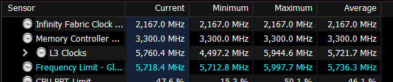

With different per-core clock speeds, how can it be synchronous? That's what I'm trying to dig into here. IIRC, Haswell added separate DVFS to Intel's ring bus, but it was still asynchronous before then.
L3 / ring runs at peak core-clockspeed for any given CCD
Reactions: Tlh97 and Joe NYC

Guess i showed the wrong screenshot if you gonna take everything in bad faith. Oncourse the difference is not that big in this scenario since the 7800x3d is among the lowest clocking Zen4.
Do i need to dig up a 6ghz screenshot of plain old regular Zen4 ?
I believe @Exist50 was talking about Intel's cache frequency in your quote, not AMD's.
That second sentence was "For Intel"....
Reactions: Det0x

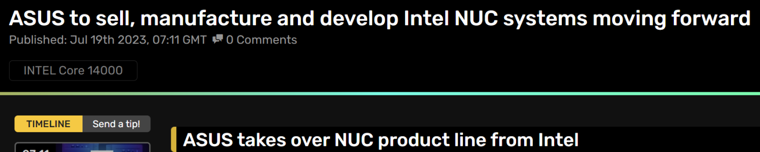

NUC isn't dead, kinda?
Likely little more than ASUS licensing/buying the brand. At best they keep using the same ODM that Intel used (though with the move to plastic housing I can't say I care much, the aluminium ones before that were nice).

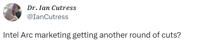

'm not convinced the engineers are unaffected. Certainly they've made drastic cuts to engineering as well. But at a certain point, hard to distinguish what "wave" of layoffs they're at, and how many actually remain.
Ian reported a new round of marketing lay offs in the past 24 hrs (yesterday). I hope it doesn't affect engineers in this 'round'. Not that I hate the people who have jobs in marketing, I mean it much suck getting laid off, but like Intel needs their engineers more than ever.
