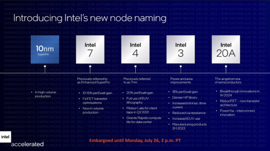

Regarding power consumption, I think you would want to compare Raptor Cove vs. Zen 3 instead of Golden Cove.
Reason: Zen 3 is a second generation product on TSMC N7, Raptor Lake is a second generation product on Intel 7.
I suspect Sapphire Rapids may be on an older version of Intel 7.
Neither holds a candle to the efficiency Zen 4/TSMC N5 is capable of.
Just my two cents.
Geddagod
Dec 28, 2021
1,680
1,715

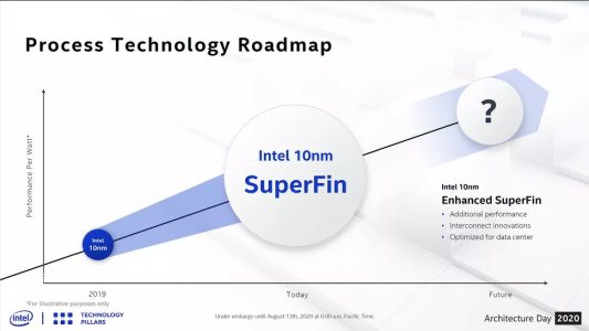

I lold a bit: Intel 7 is the third gen Intel 10nm node, and that's if we ignore the actual first gen that Intel burried. We had "vanilla" 10nm with Ice Lake, 10nm Superfin with Tiger Lake, and then 10nm Enhanced Superfin with Alder Lake.
Intel's first generation products on even their 'refreshed' Intel 10nm nodes are always pretty bad optimization wise tbh.
'Fixed' 10nm was ICL and TGL got like what, >20% better clocks? Some of that was process sure, but I also think TGL got heavy DTCO optimizations to enable that.
'Fixed', or maybe not as much fixed as heavily improved 10nmSF was Intel 7, GLC. RPC was another >10% frequency upgrade, which is insanely impressive considering the node should not have contributed nearly as much as it did from ICL to TGL.
Intel's refresh team goes hard on DTCO

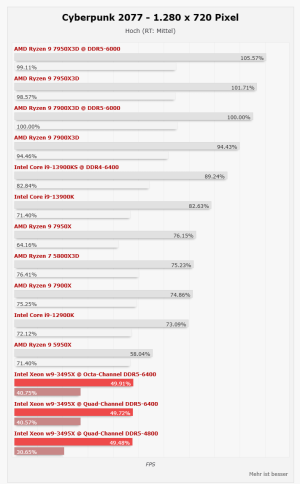

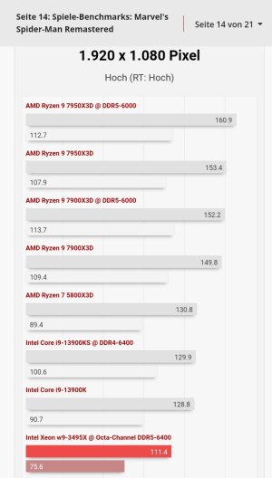

Nobody is buying these things to play games.
I disagree, I would be interested in a HEDT platform with around 16-24 cores that did well in games. The problem with the main stream platforms is not enough IO.

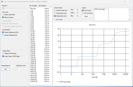

One can imagine these new HEDT Intel XEONs as basically lower clocked Raptor Lake core with 2MB of L2, no L3 cache and horrible memory latency at whatever speed due to multiple channels, mesh transitions.
Is disaster level L3 caching for games, 30-40ns at whatever speed is just retarded and will destroy gaming performance. Obviously 56C SKU from XCC die is even more useless as it has those 4 chiplets that destroy even more L3 and memory performance. MCC die SKUs with up to 32C would perform somewhat better.
AMD's HEDT chips have equally bad server SoC memory latency, but they have functioning local to chiplet L3 cache of decent size that would definitely perform quite good in games.
What is unfortunate for Intel, is this "gaming" performance deficit transcends into Server style workloads as well. For example in database loads, i'd expect Intel to completely and utterly outperform AMD, yet their advantage is not that big. Disfunctional L3 cache with disaster level L3 latency and no size to show for that latency is big part of it.
Like i've said a few pages before - IF they can sort out the process, they have architecture in place for some 512-768MB MB L3 cache chip to really shine ( or some retarded scheme with L4 cache would actually work out for them, as their L3 is hurting now, might as well abuse it for L4 tags and have capacity ).
EDIT: i was generous with "30-40ns" above, in fact it is way worse:
From same CnC review:
Up until we exceed L2 TLB coverage, we see about 39 ns of effective access latency for the L3 cache. As we spill out of that though, we see an incredible 48.5 ns of effective L3 latency.
With same tool as authors used, and 2MB TLB i get the following on my desktop
Let that sink in for a moment: desktop Raptor Lake has same memory access latency than what amateurs who call themselves Intel's engineers managed to achieve in L3 cache.
Talk about achievements in retardness, extra points due to having IMC on same "chip" and lifetime award for working in company that had industry leading MCs for half a century.
