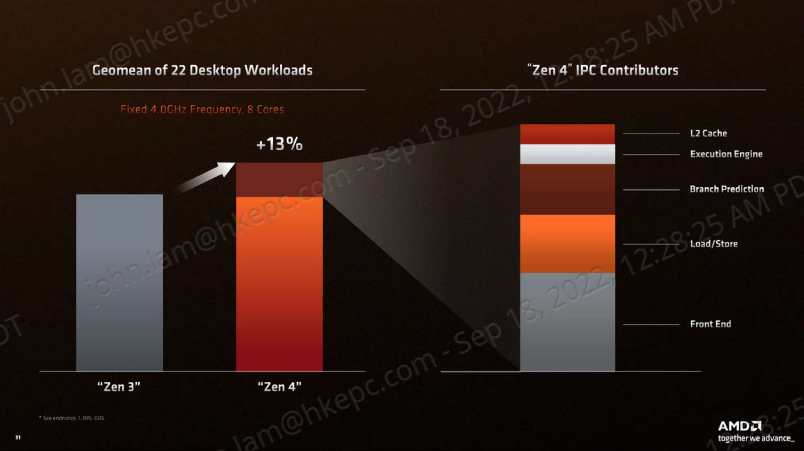

While Intel doesn't often release IPC breakdowns of their new architectures, AMD does. And based on Zen 3 and Zen 4, branch prediction changes really didn't cause a major change in IPC compared to other changes in the architecture. And I swear Intel claims better branch prediction every gen, prob cuz they tweak it a bit every gen, didnt they claim it for RPL as well?

AMD explicitly states the IPC improvement contributors since at least Zen3. This one is for Zen 4.
As @IntelUser2000 already mentioned: In addition to direct gains the Branch predictor also acts as an enabler. And it also has a huge part in minimizing wasted processing and therefore improving efficiency.
