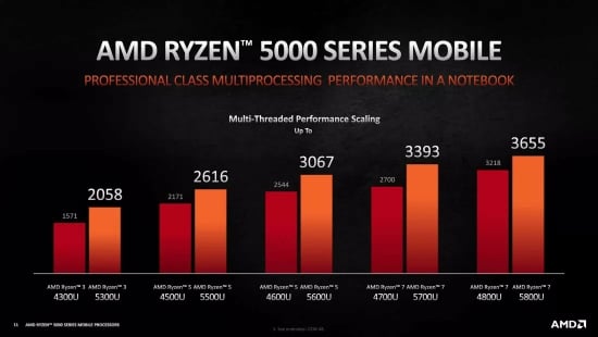

14K Cinebench R23 and 5K+ R20 in 28W is what Rembrandt is.
Is it? Because that's a whole lot more than '25-30%' faster that AMD themselves claim over the 5800u:

The Cinebench numbers are bit high but I believe the 30% gen-on-gen is going to be true, because the base clock increases greatly, which suggests power handling has improved greatly.
Once again, do you really compare 15W Cezanne against 28W Rembrandt? Really? If you think 30% is tested versus the same power your are wrong once again. AMD even admitted there is no 28W Cezanne U device in the market (no idea if true or a silly excuse) and apparently there is a 15W slide with less gains.
It's funny that you say that, when AMD's reference numbers last year on launch are 25W figures, not 15W figures.

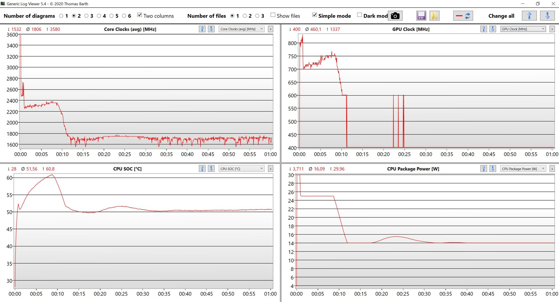

Actually there s designs that get to 15W after some time, CB R15 perfs can be extracted from the graphs below.
1924 pts@30W
1820 pts@25W
1420 pts@14W
Thanks for the link! Reading a bit more carefully it seems that at 14W the score drops to 1244 while for the 1402 score it is looking closer to 19-20W.
