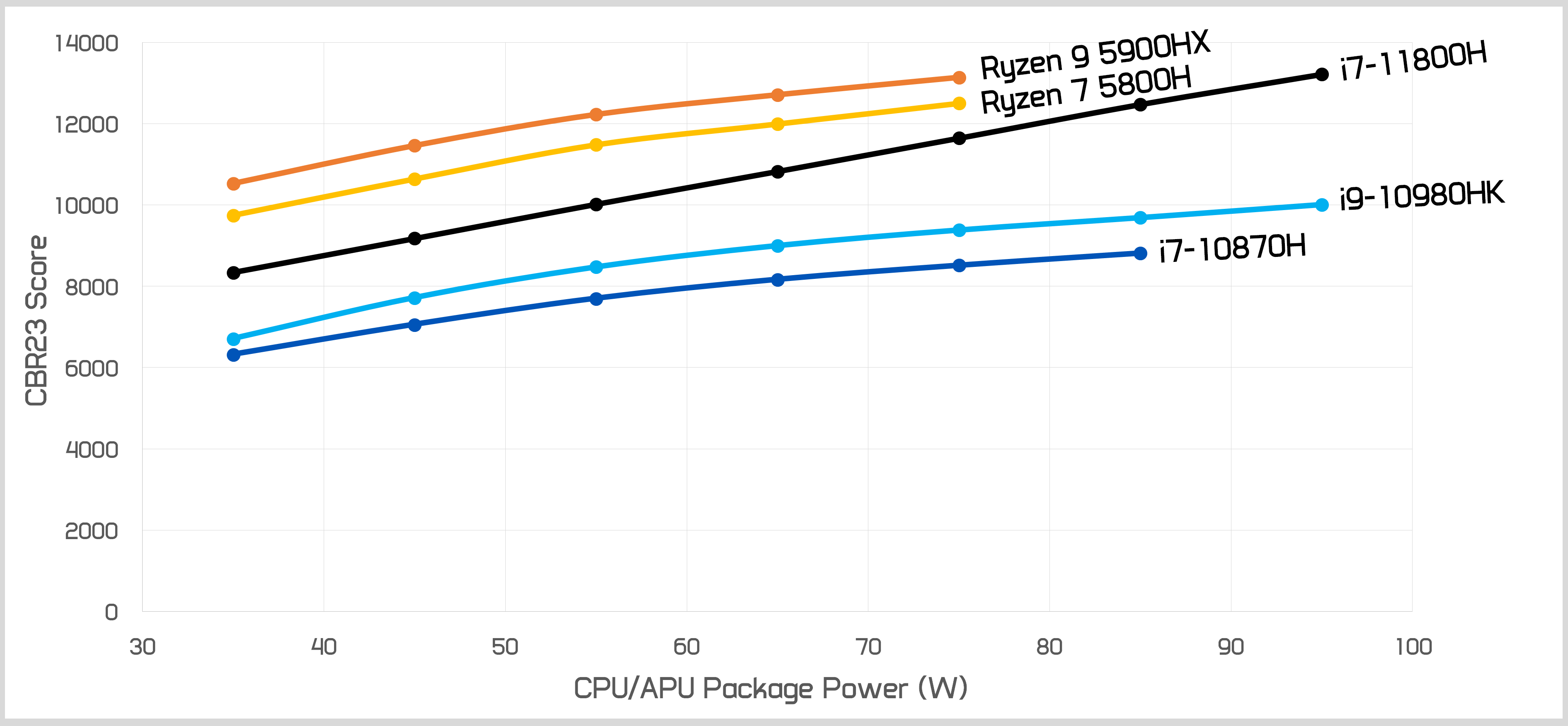

35% higher score after increasing TDP to 241W.
This graph shows one problem with Alder Lake and that is clockspeed at lower TDP.
If we assume that at TDP:241W the clocks are P: 4.8GHz and E: 3.8GHz, then It would mean at 125W It is only P 3.6GHz and E: 2.8GHz based on the difference in scores. That is pretty low for desktop.
Then what about 65W? Clocks must be even lower.
Mobile Alder will be even more limited, although they have less P cores.

So 12400 has the same efficiency or a bit better than 5600x at least If It's at 4GHz, right? How did you come to the conclusion that ADL is hugely more efficient than Tiger Lake? Zen3 is not that much more efficient at higher power draw than Tiger Lake.
Techspot
At 75W Zen3 is about 10-13%. I can't say that is a huge increase in efficiency.

The 12900k limited to 125W doesn't seem too impressive though. At least not in R20. The 5900X (142W) wipes the floor with it in MT.
I think the same. The clocks should be pretty low at 125W TDP, as I calculated in my previous post, that's why I wonder about the laptop version, at least the Alder Lake H.
Ryzen 9 5950X is capable of 9801 points without OC or PBO.

Am I missing something?
13.3% higher score for 18.1% more power should be considered lower efficiency.
Assuming linear scaling? I think it's close. The example @mikk used had to do with FPU code so it's possible in that scenario, Zen 3 is not as efficient.
