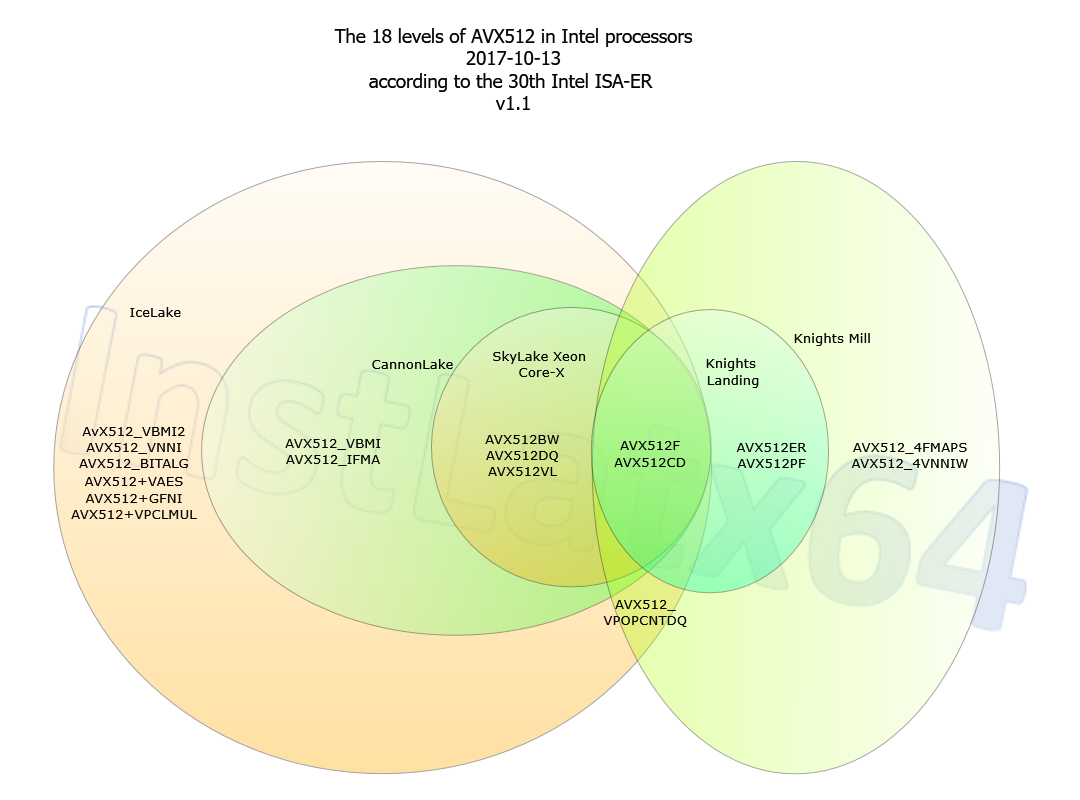

https://software.intel.com/sites/de...tion-set-extensions-programming-reference.pdf
Updated Instruction Set from Intel, includes Icelake, Cannonlake and Goldmont Plus

Investing the density increase of 10 nm to add AVX-512 to everything, even a Cannon Lake laptop. Except Atom. Unless the document did not bother to differentiate client and server.

AFAIK Cannonlake is now only mobile, I suppose the CNL 2+2 70mm^2~ die size makes a little more sense now? Though AVX512 on what is only Y/U parts is a bit weird, no?

Theoretically, more FLOPS can be done with AVX-512, without increase in power from AVX2, if AVX-512 is offset in frequency. If you happen to use an app that supports AVX-512, on a laptop, more productivity on battery? Quite a stretch.

AVX512 instruction support does not mean Intel has to include 512bit wide vector units, as shown by AMD and AVX2/FMA support without actual 256bit units. But that is speculation of course.
Still, for mobile it is inefficient to even include the massive register file required for AVX512F support as that bloats things up big time.

AVX512 will just bloat these chips up big time. Average Joe doesn't care about that if there is no effect on apps he runs every day. Better invest the die space in something that matters, like iGPU or cache, better int performance, higher clock.

I've noticed in the table above, that Ice Lake will have Fast Short REP MOV support. That could actually have a larger impact in crazy memcpy land we have now. Instead of crazy optimizations, where sizes, aligments, AVX256/512 instruction madness, future memcpy's could run each case with REP MOVs instead. Great real world optimization.

Looks like it's been added to CNL and beyond.

My guess is that they'll do it by splitting ops across the two AVX-256 ports, similar to how to the "first" AVX-512 FMA works in SKX. I doubt we'll see the second FMA turn up.
Gives you software compatibility, increased register space, and the improved instruction set (e.g. operation masking, scatter instruction) without blowing up the core size/power budget too much.
