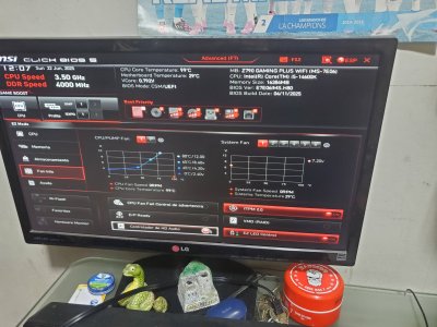

After assembling the system and powering it on, I immediately noticed the CPU temperature jumps to 100°C, even though the heatsink and the CPU surface don't feel that hot to the touch.
Initially, I noticed that the CPU fan header was incorrectly connected, and the UEFI showed 0 RPM for the CPU fan. I corrected this, and now the fan is spinning properly. However, the temperature still starts around 50°C and quickly rises to 100°C.
I also noticed the case fans are spinning(3), is Ok the temperature. They are connected to a built-in hub via 6-pin connectors, and the system reports 0 RPM for system fans as well.

If the CPU reaches 100C while in BIOS, then clearly something is preventing the cooler from transferring heat. Yes, the cooler is very underpowered for this CPU, but it should still be able to prevent the CPU from reaching Tj Max under low load, especially while in the UEFI. Look at the image the OP has posted, the CPU is @100C while VCore is just under 0.8V, that CPU is using very little power and still cooking itself.

Make sure that a CPU overclock isn't in effect in the BIOS. I've started using MSI boards again recently and found that by clicking on that 'CPU' icon in the BIOS as soon in your photo, it does an auto OC.
