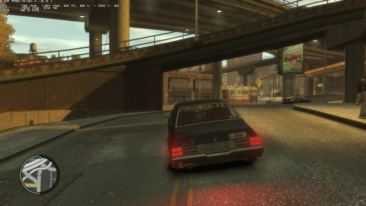

I did my own testing in GTA 4 and others are welcome to try it yourself in any game and post results.
for GTA 4, I ran two different benchmarks in two different locations.
aero enabled
Min, Max, Avg
29, 96, 59.719
aero disabled
Min, Max, Avg
43, 109, 69.977
about 17% faster with aero off
aero enabled
Min, Max, Avg
28, 90, 48.372
aero disabled
Min, Max, Avg
40, 93, 62.825
about 30% faster with aero off
and it used 200-300mb less vram with aero disabled.
EDIT: screens
aero enabled
gif hosting
aero disabled
image host
EDIT 2: so bottom line is it was all vram related in GTA 4 even though I was not even using within 100mb of my available vram with aero on. so dont expect performance increase if you have plenty of vram. if you are anywhere close to borderline with vram though then turning off aero will help in a vram hungry game like GTA 4 though

no I was not vram limited at all. I never even used all of my vram with aero enabled. and screenshots added too.
I am not saying all games will be faster. the only reason I tested this game is because someone else said they had a big performance increase with aero off.
