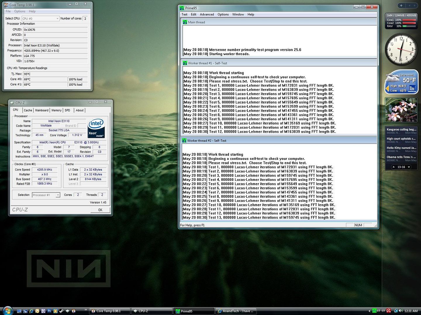

I was tweaking a bit tonight, and am looking prime stable at the following
http://i36.photobucket.com/alb...Internet1980/42ghz.jpg
Memory is 1:1, 5-5-5-15-54

nice E3110 @ 4200mhz 1.31 Vcore!
Thanks fellas.
I'm glad this chip is this nice, or I'd be somewhat salty.
I traded a Q6600 G0 (did 3.4 @ 1.3475v - albeit the temps were terrible) straight up for this Xeon. 🙂
