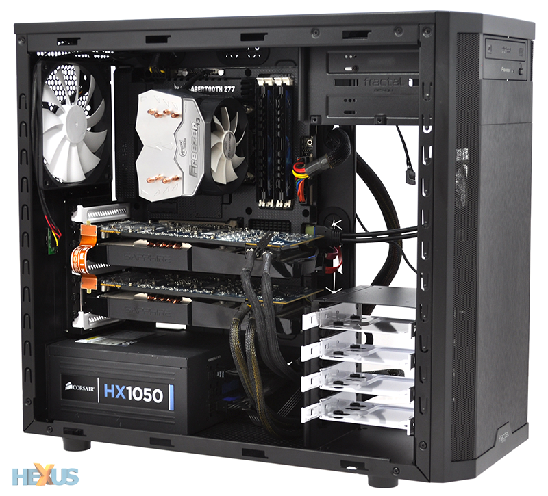

This is my case (not my equipment):
https://geizhals.de/fractal-design-core-3500-fd-ca-core-3500-bl-a1119963.html
(see multiple product images there)
I have already installed 5x 140 mm fans:
- 2 front (inward)
- 1 bottom (inward)
- 1 side (outward)
- 1 back (outward)
Does this make sense?
If I have enough space (looks like) I would definitely mount the WC radiator to the top. I'll have to route the ducts around my NH-D15, though.
EDIT: Seems there is enough space: ~5.5 cm between the CPU cooler and the case roof.
