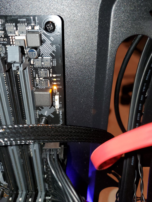

Nothing worked. Removed CMOS battery for around 10 minutes. No dice. Turned it on and walked away for 15 minutes. No dice. Tried booting with 0 sticks of RAM - same thing. No matter what I try, there is nothing being outputted to the monitor (no signal). Everything powers on/spins - all pretty and lit up, but I am getting no output to the monitor (I know it's not the monitor or the display port connector as I'm just unplugging from one computer to the problem one).
The only clue I have is that the "DRAM" light is staying lit up regardless of whether I'm using 1 stick, 2 sticks, or no sticks. Motherboard manual says if light stays on, there's a problem there.
This is just a quick picture with no sticks of ram in there:
img]
