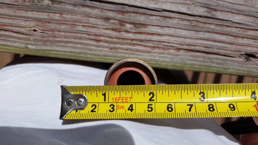

See photo.
The outside diameter of this garden hose spigot from thread tip to thread tip is ~1-1/16". The outside diameter if you were to remove the threads is ~15/16". The inner diameter of this spigot is 5/8". There is nothing that measures 3/4" anywhere here.
This spigot is coming from a water drum, but garden hoses hook up to it just fine.
Is that marketed as a hose fitting? Looks like a big cooler.
