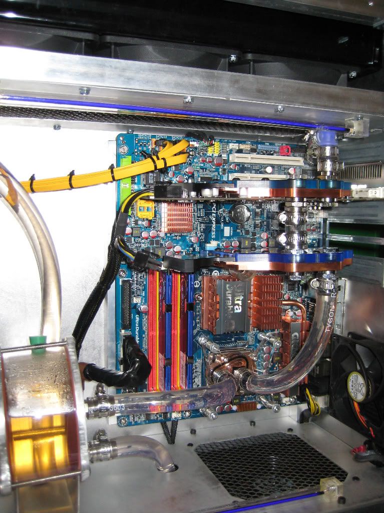

Can you tell me your loop order,
Also a picture.
I dont understand how your cpu temps are so high and your water temps are that cool. Its telling me either your TDX isnt doing its job because theres a contact problem, or you looped your TDX wrong so the outlet is the inlet, and its not working properly.
A picture would it up very nicely.

Rez -> pump -> Rad -> HD3870 1 -> HD3870 2 -> TDX
I ordered a dtek fuzion. Hopefully my archaic, unbowed block is the problem. The thing was designed for old AMD chips without a IHS.
PIC: http://i28.photobucket.com/alb...an666/IMG_0490_sfs.jpg
As you can see, there's no second video card, just a floating water block :p It is being RMA'ed... hopefully should be back next week.
Found your problem:
You put your GPU's b4 your CPU. Now full covered blocks can dump a GRIP of heat into your system. So the water is getting quite warm by the time it reaches your cpu.
Try moving the CPU up front if overclocking is your prime, and then feed the gpu's.
However i still recomend you splitting the loop up into two.

I honestly do not think that is an issue. The delta T between the inlet and outlet of a single water block is usually < .5C
Lol, besides, re ordering the loop would be impossible for me to do. I built and designed this case from scratch

actually it was tested on XS and shown by synx that having a full cover gpu 8800GTX on the loop can raise your temps by almost 7-8C.
http://www.xtremesystems.org/f...ghlight=fullcover+core
His last comments:
Conclusion:
I knew I was going to use the EK full cover block in the end, but always wanted to know what the difference would be. These types of things bug me for not knowing.
I already had a MCW60 laying around and just had to buy the G80 bracket. I kept everything the same as much as possible. I believe that just about any water cooling solution used for the 8800GTX would be vastly better than the stock air cooler. Temps were almost cut in half.
By the way the 8800GTX at full load added about 7-8°C the the CPU core temperature.
These guys arent the coldest running gpu's ya know:
http://i125.photobucket.com/al...aigomorla/IMG_0886.jpg
So i know what im talking about. With those kinds of cards on a full cover, you really need to split the loop up. :T
But besides that, im still betting on the contact problem.
ohhh i remember that case now. Do you have nozzles on your TDX? I really dont get whats wrong besides contact problem, and gpu's on the loop.
Those are my two main guesses at the moment. Did ya lap the cpu? you might wanna try that as well after you tested it on stock for a few days.
or you might just have a bad quad that cant overclock very well. :\

I won't argue with the 7-8C temp rise, but I'll bet that the order of the loop doesn't matter and that the temp rise is due to the increased restrictiveness of the loop with the GPU blocks.
Yea, at this point, I am thinking it is a contact problem due to the convex IHS. I do have a nozzle (stock) on my TDX. I originally didn't (I took it off when I swapped the A64 top for a S775 top) but my temps were hitting 85-90C load.
At this point, there is only 1 GPU in the loop, but both blocks are in. My 2nd 3870 is currently being RMA'ed and I didn't feel like taking the block out of the loop so I just unscrewed the card from the block while keeping the block inline.
The CPU is not lapped; something I should probably do though...

Yep, neat bit of work. The loop order is just a pet peeve of mine, without question the order would not affect temps to the degree that your seeing.
Concave chip? Are you using a backplate?

OK, so I got the Dtek FuZion installed with an o-ring to bow the block, a backplate, and the nozzle for quadcores.
Old temps were with 1 idle hd3870, new temps are with 2 3870's @ full load
full load temps (all 4 cores @ 100%, GPU's @ ~95%)
CPU:
45 46 40 48
GPU 1:
47
GPU 2:
45
semi load temps (all 4 cores @ 100%, GPU's @ 0%)
CPU:
43 44 39 45
GPU 1:
34
GPU 1:
36
idle temps (all 4 cores @ ~2%, GPU's @ 0%)
CPU:
32 33 28 36
GPU 1:
33
GPU 2:
36
For comparison, here are the old load temps (with only 1 hd3870 idling):
CPU: 63 62 58 63
So, even though there are now 2 3870's dumping 200w of heat into the loop, CPU temps are still 10-15C lower! Damn swell! Time to finally overclock this chip!
