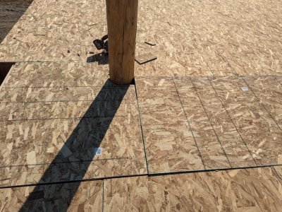

118.5" and that matches with the subfloor.
The rest of the log goes on top of that, an additional 27'.

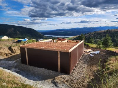

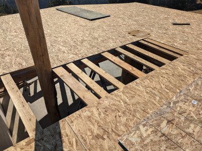

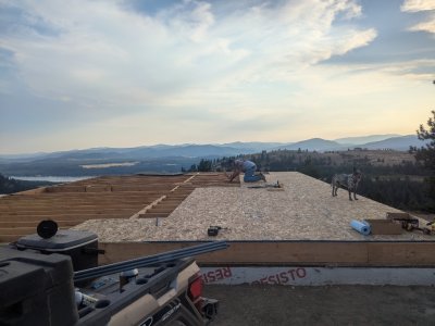

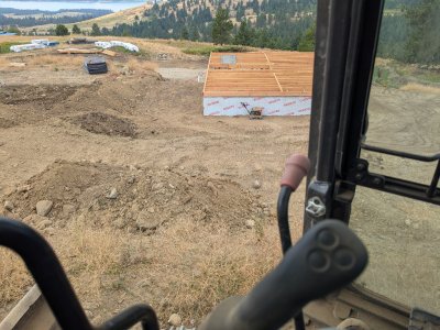

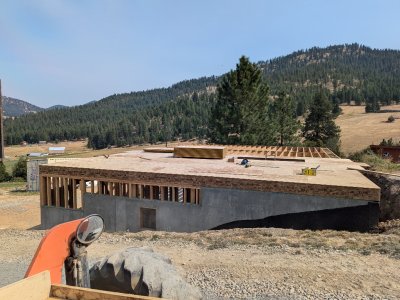

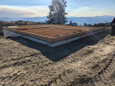

We had to shim the rim due to variances in the concrete and mud sill. I ripped and planed all that, and cut and fed rim and joists. We got about half the joists in.

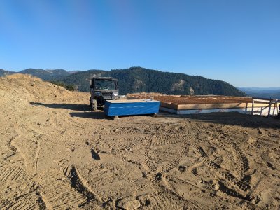

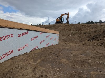

Trying to understand this pic. Terrific view!
In this view are 2 or 3 sides ICF?
Do the ICF walls get backfill placed against them or are there just no windows on those sides?
Is the rock under the foundation required for stabilization, plain fill or drainage?
Construction is different here in FL as you can imagine.
3 sides. The prow front wall is 2x8 framed. The icfs do get backfilled against, there are two windows 4x4s out towards the end of them. So the backfill will taper down and expose those two windows with the minimum of 6 in.
Rock is footing drain. Footings sit on undisturbed native soil.

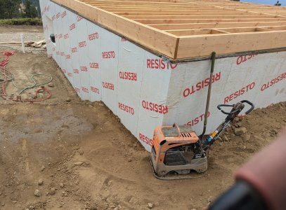

That was an epic hole to fill. The guys who dug it took about 3 days with a 30 ton excavator, and they put the dirt where it was convenient to THEM!

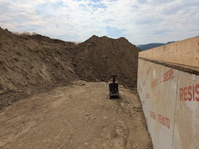

I tried to rent a 16 ton for the backfill, and a roller.
What I got was this little short armed 8 ton and a 330 pound plate compactor. It was a slow slow go, but I did it proper in small lifts and used water for compaction.
A big machine I would just reach in from above and grade it, but with the 8 ton I had to get down in the bottom of the fill and it was tight quarters for the first 6' of depth.

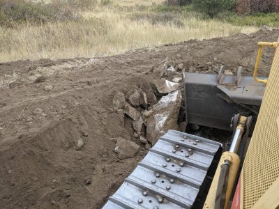

Somebody asked , why did you not use a dozer, since the fill was so far away? Here's why.
Nuggets. Lots of boulders. Those are a bane on a dozer and then you'l note that I have nothing but finer stuff against the waterproofing. That is a bad several days on a dozer and off again with a shovel trying to keep the big rocks off the foundation.
This is how discouraging it was. The big excavator had just casually tossed the dirt up by the fence, all over with a 30' radius. That meant he could get it 60' away with no effort. Looking down:
Looking back up. It was a few tosses to get it back.
The bench behind was ~4' too tall so I harvested a bunch of that, but it was hard virgin ground with those integrated rocky features in it.
I brought it up to 20" below FF, which 2 steps in front of the porch for 3 rises.

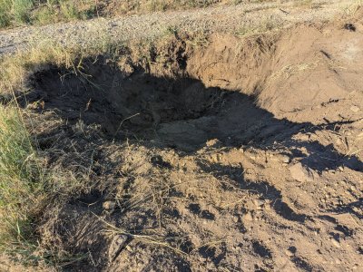

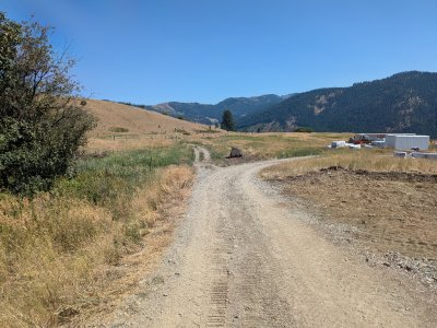

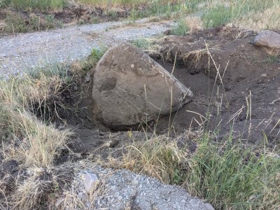

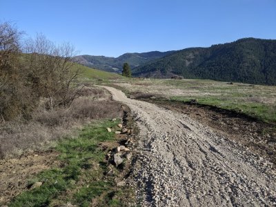

speaking of rocks, maybe you remember the Leaverite I went past building the road? I had a 21K pound dozer and gave it a little test love tap. Nope.

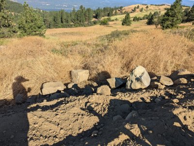

Some of this is fracture rock, looks solid but you can get it to bust apart. Example:
This thing had the F U heat treat on it. I went right on by 😀

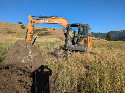

So his girlfriend is an owner/operator with a new Kubota 35 and skid steer. She does good work but does not have a ton of real world experience, and she just HAD to try and get the Leaverite with a 35. It cracks me up every time when somebody says hold my beer.
So how did that go for you again?
" this rock just keeps getting bigger"
I suppose I could relent and roll it out with the 75, but what is the fun in that?

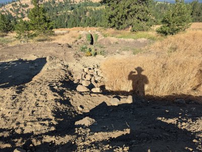

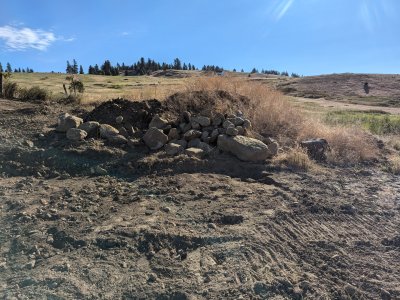

I got lil nug nug up on the surface. I had to set up a ramp and slide it up, then hold it and persuade it until it liked that spot, then repeat. ( Say Lil nug nug with Beetlejuice voice for proper effect)
They thought the rock was a hazard by the road! What about the Crater?
Final disposition. I wrestled it around briefly looking for a good side and then filled in the hole. Now it is high and proud, a feature rock a few feet from the road.

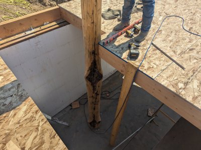

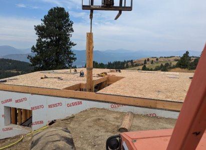

This is the Bannister post for two staircases stacked. We got it clocked around to show the best features. It has some big knots in it.
The moment we were done setting that post, I started safing off that stairwell hole and did not stop till I was done. This bumble does not bounce!
Tomorrow we will get the first course of logs on and get a system going, then it is full speed ahead with a bigger crew and me on the telehandler.

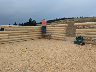

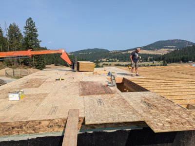

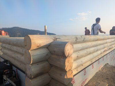

It took a couple of days to locate and bolt down the starter course. I kept busy doing other things.
First day of setting on Thursday:
End of the day today:

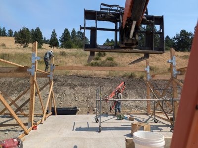

My job is to locate the logs needed and have them ready.
Hovering standby with the next log. Come on guys!

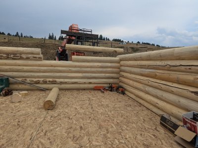

Those logs look nice and uniform, are they being turned in some kind of machine to make them that way or just got really nice trees in that area?
I sometimes toy with doing a log cabin build but my trees are fairly small, so I'm better off milling it into 2x material and doing more traditional build. For my first build I will probably buy the lumber as it will be faster. There's a local sawmill here that is reasonably priced.
They are milled from standing dead trees from fires. These are a uniform 9" log with a swedish cope cut in the bottom.

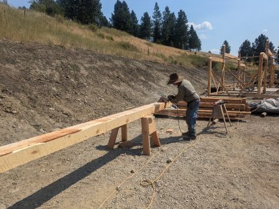

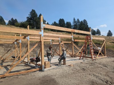

Today was "help your neighbors" day. My friend went for a resupply, which is a few hours away, and I went to another nearby cabin job and set the subfloor out there. He was packing it a sheet at a time across that 2x10. I drove over and hit the easy button.
Off to the next gig.
See the hill across the valley, the break in the trees in front of the boom in the first picture? I had to drive down in the valley and back up to the next gig, a barn raising to set loft beams. Check out these rough fir timbers! They were sawn 13 miles away on a small mill. It is the typical witches hat shape with a loft in the center under the high pitch.
