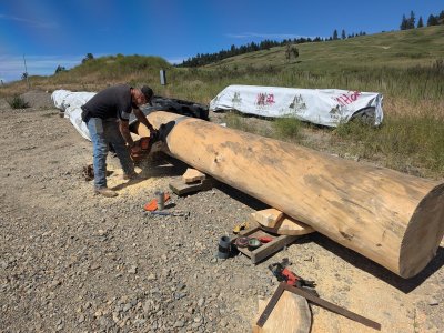

The prow wall is framed in and we are laying out and cutting the king post that goes from basement to loft. Fortunately we do get to cut it at the first floor. It is a massive pine log 26" diameter that does not apprecialby taper in the first 10'.
We have to lay out and plunge cut beam pockets in it tomorrow, then start framing the first floor.

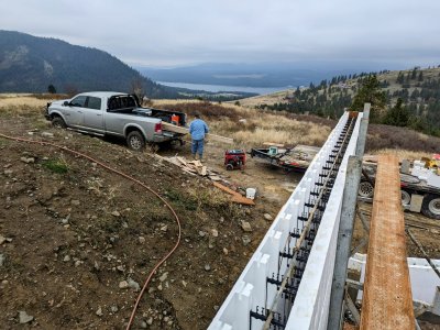

These are some of the views from his place. Lake Roosevelt to the SW
Sunset the other day
Pour day for the Insulated Concrete Form (ICF) walls in November.

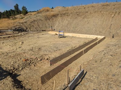

digging for footings in August.
View to the ENE of the lake.

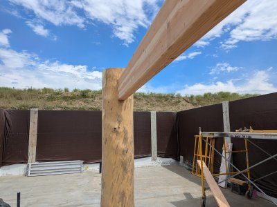

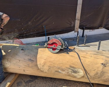

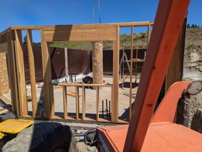

We laid out the floor, stood it up, and then sanded one spot on it to get it to quit rocking. That was it. Marked the cardinal points on it on chalk lines snapped on the floor. Used the laser to set the top cut and beam pockets, then tripped it and went to work with the saws.
Here is sits looking through the picture window, about as subtle as a 40 oz FOSTER's <Australian for Beeyah!>
on a table full of 12 Oz Miller lites. It puts the log in cabin. Other cabins have King Post envy.

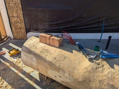

Under the knife
I initially plunge cut the sides with my BigFoot baby beam saw. It shoots through schools! < nod to Joe Piscapo in Johnny Dangerously >
I had a few bad touches to fix up. Nothing for a little sawdust and glue and maybe a sharpie to fix. ;)
We are ready to stand it up permanently. I rotohammered a piece of rebar into the concrete and drilled the bottom of it. You never know, some big kids roughhousing could knock it out of place. :D

I wish I had some of those tools today. A big ass sharp chisel and a mallet would make some nice clean work.
2" framing chisel
If I did more of this work I would have a set.

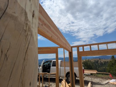

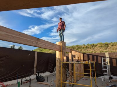

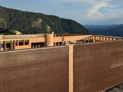

We got it permanently mounted and the glue lam stuffed into the mortise. The grade on it was dead nuts!
There's a structural wall at the back to provide a continuous wall line to land the floor joists on.
Tomorrow we'll start grading out and setting the first of the double rim board, then we'll start putting in floor joists.
