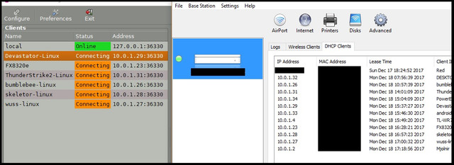

Back to remote access for F@H...
I have all my clients added to my computer from which I will be monitoring the systems, but none of them are connecting. Do I need to do something to the systems that will be getting monitored, to get them to communicate?
I've tried
  • completely disabling the firewall on the main computer, and
  • I've tried entering the range of addresses per Stefan's post, on one of the remote computers, but no luck.
StefanR5R
Dec 10, 2016
6,529
10,208
After you whitelisted the monitoring address on the client, you may need to restart the client.
$ sudo /etc/init.d/FAHClient restart
Also check whether there is a desktop firewall active on the client.
And verify whether or not the client is configured to require a password for remote access.
If you use host names instead of IP addresses, check that the monitoring host can actually resolve this host name.
$ nslookup client_name
TennesseeTony
Aug 2, 2003
4,328
3,797
www.google.com
Am I supposed to have this in BOTH areas (for the main computer)?
StefanR5R
Dec 10, 2016
6,529
10,208
I have both to be sure. One or both are required on each client.
Oh, you actually want 10.0.1.0/24 there (or just the address of the main computer, if you never monitor from another one).
TennesseeTony
Aug 2, 2003
4,328
3,797
www.google.com
Firewall on Mint boxes is off by default, passwords match, changed the obvious error mentioned above (doh!), restarted client(s), but still not working.
I'm using the right addresses, from my router's DHCP list, right?
StefanR5R
Dec 10, 2016
6,529
10,208
Is the 10.0.1.* network just a switched Ethernet network, or is it routed?
It's the former if e.g. "traceroute wuss-linux" on the controlling node shows just a single hop.
It's the latter if it shows e.g. two hops, with your router in between. In that case, make sure the router forwards traffic from/ to port 36330.
PS,
if you use DHCP, are the IP addresses fixed e.g. for specific MACs? If not, better enter the host name instead of the IP address when you add a host to FAHControl's side panel. Assuming that the host names are persistent.
TennesseeTony
Aug 2, 2003
4,328
3,797
www.google.com
Stefan.....shouldn't you be asleep? :p
Switched connection, but very likely to get new address(es) every 24 hours, or every restart of a host. I love the stability of the Apple router, but...it's far too simple. Every time I do something 'advanced' I'm without internet for hours or worse.
LOL, traceroute came back with 'less than 30 hops.' My 'local' network is not so local? I'm 'sharing a single IP address' with all my hosts, according to the router, I forget what the other option is, but I do recall that's the one not to mess with. :(
Probably need a new thread, "Home Networking Guide for complete idiots." :D

Will attempt to get Folding on my only (for now) Linux machine. I am going to follow the install TO THE LETTER and hope like- yeah that place- it works this time.
I certainly wish I would have switched to Linux a long time ago, the efficiency and not having to deal with forced updates is worth the frustration for a newb installer, non-programmer person.
It just works............for the most part........ after you figure out the kinks!
