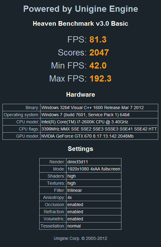

[/URL] Uploaded with ImageShack.us[/IMG]
Test ran using I7 950 plus 6 gig ram

Looks like the two GTX670s are pretty consistent above. Doesn't surprise me that a highly overclocked 7970 can edge them out.
