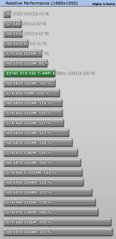

http://www.techpowerup.com/reviews/Zotac/GeForce_GTX_550_Ti_Amp_Edition/23.html
Comparing the AMP! edition with all other cards at stock isn't a very good comparison at all.
This whole exercise seems like it was concocted by a marketer.

A lot of checklist. Not a lot of result since none of the above seems to have added anything.
Why didn't they just rename the 460 the 550?
The 460 has 75% more SPs in it. The 550ti has to be much cheaper to produce. The cynic in my agrees with the idea that they picked a small core count to cut costs and then checked off a marketing feature list that they could include on the cheap and are seeing how much money they can get out of it. :thumbsdown:

550ti
streamprocessors= 192
GPU= 900mhz
Shader= 1800mhz
Mem= 1026mhz (4.104GHz data rate)
^Above card at stock is probably clocked near its limits. Which explains why it uses SO much power for its performance level.
460 768:
streamprocessors= 336
GPU= 675mhz
Shader= 1350mhz
Mem= 900Mhz (3.6GHz data rate)
^ Above card has lower power use, LOTS of overclocking headroom, slaughters the 550ti in performance.
I know 5770 overclock like mad, Im betting a highly overclocked 5770 is probably a faster card than a 550ti overclocked (because its already at its limits). And the 5770 is like 50% cheaper.

1) horrible value buy you did.
2) 4890 trades blows with a 460 768... so yeah a decent performance hit.
You just spent 150$ to go down in performance... oh well.
You ll have Dx11 now though.
*if* its possible to return it, Id do that, get the money back instead get:
A) 460 768mb ~130$ (abit faster than the 550 ti)
B) 5830 1gb ~130$ ( much faster than the 550 ti)
save yourself those 10-20$ and get much higher performance card.

Looking at the charts the 4870 seems to beat/match/lose to the 550ti by small margins, so the 4890 is in all likelihood is a better performer than the 550ti.

Yes return it, both these cards are cheaper, faster, more power effecient.
B) 5830 1gb ~130$ (much faster than the 550 ti)
or you can just keep the 550ti, returning stuff is always a slight hassle.
But then you ll live knowing you threw 20$ out the window, and got a slower/more power hungry card than you could have had.

The 5770 used to get defended , to have evolved to be faster than the 4870 in these forums. And the 550 gtx is faster that the 5770.
So you may have gone sideways in power. You now have a dx11 generation card. You can tell us how DA2 dx11 performs for you. The 550 uses the newest driver, that is purported to work better, I believe.
