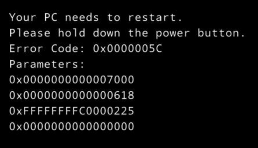

Motherboard H13SSL-N, Windows 2012 R2 crashes on install - right after loading files and showing Win logo for a second.
Grrrrrrrrrrrrrrr, not happy.

Isn't that OS too old to run on Genoa ? Or any modern CPU, server or desktop. Its 13 years old !

0x0000005C = HAL_INITIALIZATION_FAILED
Alas I don't know how to decode the four parameters.
Look for APIC related options in the BIOS, as well as other OS compatibility related options, and try different settings.
--- Edit: ---
Try with IOMMU disabled. (It should be in the North Bridge settings.)
Furthermore, if you want to install the OS onto an EFI boot medium, then you should also boot the install medium in UEFI mode, not in legacy mode.
Yep, found that and disabled - it stopped crashing there!
Was also looking for "Local APIC Mode" which as motherboard (H13) manual says should be present (BIOS >> Advanced >> CPU Configuration >> Local APIC Mode) but it's not in the list! BIOS version 3. It seems though that disabling IOMMU might also disable X2APIC
Windows install now does not crash straight away after showing logo, doing something spinning the wheel - will let it be for now, maybe just very slow, but doubt it.
Great tip about UEFI, did run into that!

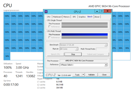

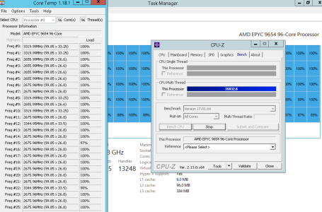

Well, 3.55 Ghz all core boost seems BS - or am I doing something wrong? Freqs are not even among cores too, this isn't well cooled area, so might affect things for sure, will retest when they are in proper DC cooled area.
Test with OCCT. CPU-Z caused pretty serious coil whine on my 128 thread Epyc ES. I have yet to experience something similar with any other benchmark. Maybe it's just too harsh and unrealistic a benchmark for server multicore testing.
3.48 is what I get (all core load)
I only get 2.7 all core speed, and you said "not well cooled". I plan to get a 360 AIO and then I will hope for more speed, but you seem to be doing well.
Using same stress test from CPU-Z? Perhaps it's lack of air cooling then, which is very plausible given that we put them into tiny assembly office for now
So is it 2.7 or 3.48, getting confused here, sorry!
It's also possible Win 2012 updates lowered down max boost for one reason or another - vanilla install (before multiple waves of patches) was showing CPU at maximum 3.7 ghz, however at that time it was in 32 code mode to get it to work in the first place (win 2012 did not like all 96 cores enabled at start). Problem is that H13SSL-N lacks official support for Win 2012 - so maybe it even runs quicker than it reports, I've seen Win 2012 on supported (!) Icelake show higher clocks than it was capable of.
We've got pairs of those CPUs so will install Win 2019 trial that is supported by chipset drivers and compare side by side in DC cooled environment.
9554 is 3.48 and 9654 is 2.7 (needs cooling) Stress test is avx-512 stuff from primegrid, real load.

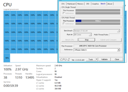

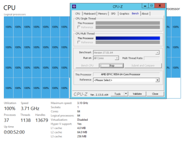

Win2012R2
Dec 5, 2024
1,281
1,331
Boxes in DC, same stress test:
AMD 9554 (64 cores) shows nice 3.7 Ghz, which is just little shy of 3.75 ghz all core boost, can't complain here
AMD 9654 (96 cores) - just 3 Ghz instead of claimed 3.55 - grrrrr!
Interesting that IPMI shows System Board power only around 240W, which is a lot lower than I expected!
CPU-Z is CPU-Z, and your actual planned workload is going to be something else...
At least you did get 1.24 times base clock on the 9654, whereas you only got 1.20 times base clock on the 9554.
360 W (or even 400 W if you switched to that) for ninety-six cores is not much.
When they say "low activity workload" in their footnote, they really mean it. Certainly just some light integer stuff, lots of waiting for memory accesses, without padding the latter by SMT usage.
