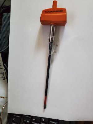

This solution is not as good as Stefans, but it suits me well. The long adapter is for the huge heatsink. Its taped onto a stock threadripper wrench with the stock T20 adapter removed.
