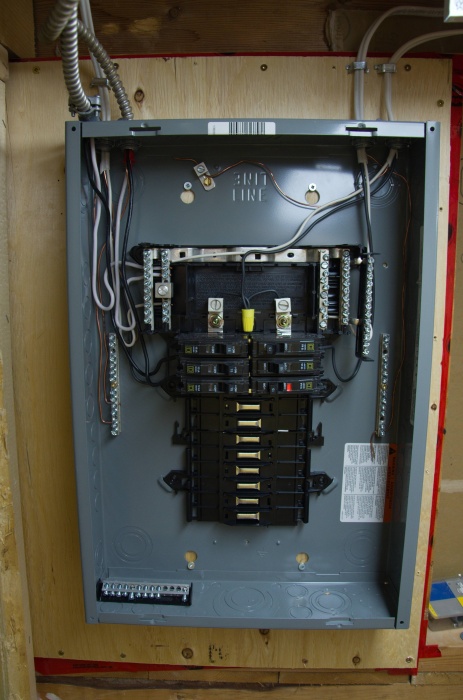

That's correct. If you want to power both sides you need to connect the two together, this can be done at a dryer plug or the panel. You get a thick piece of wire and jumper the two. Don't forget it when you turn the main back on!!! If you do forget it, you'll be reminded fairly quick about it when you do turn the power back on. 😛
I have an electrical panel that is basically wired that way:
Notice at the top how it's jumpered together. That is somewhat temporary though, when I upgrade my main panel to something physically bigger with room to add conduits/big cables coming out, I will run a proper feed to this one. This particular panel obviously can't do 240, as it's only wired by one leg of the upstream panel.
1 and 2 are on a
3 and 4 are on b
5 and 6 are on a
etc....
I hope those 14's feeding that panel are on a 15 amp breaker. That panel is a really bad idea...
